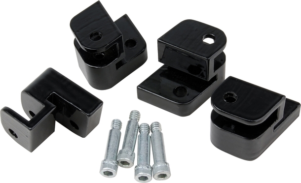

I think these lift brackets would move them back the width of the bracket.
I want to move the floor boards back on my crossbones so I may do the mod discussed above. The only other alternative is banana boards which give you 4" to the rear but I just dont like the looks.
