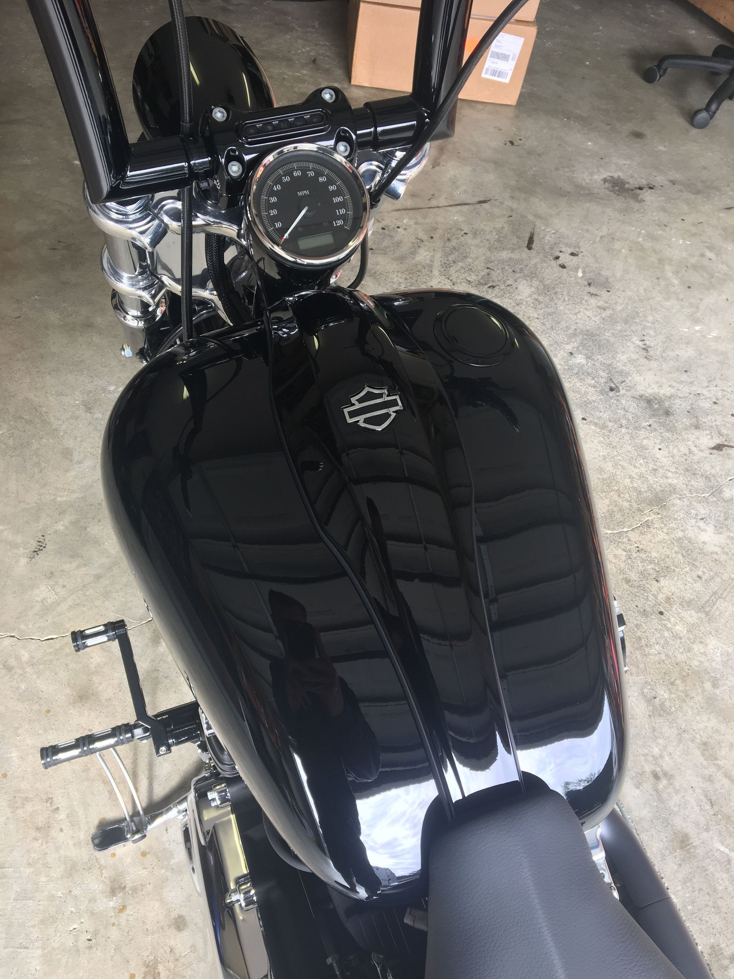

Thanks to the advice from MoneyFor, I got my blackline console completed this weekend. I made my own bracket so I didn't have to replace the top plate. Just took some 1/8" scrap plate steel and made a tab, tapped the holes, and installed new console. The extra money that I didn't spend on that stupid top plate, I used towards a flush mount gas cap. Turned out nice I think.

And here's some more pictures of the new dash...it looks soooo much better, IMHO. Maybe because my bike is black, but I just think it dresses it up nicely.
