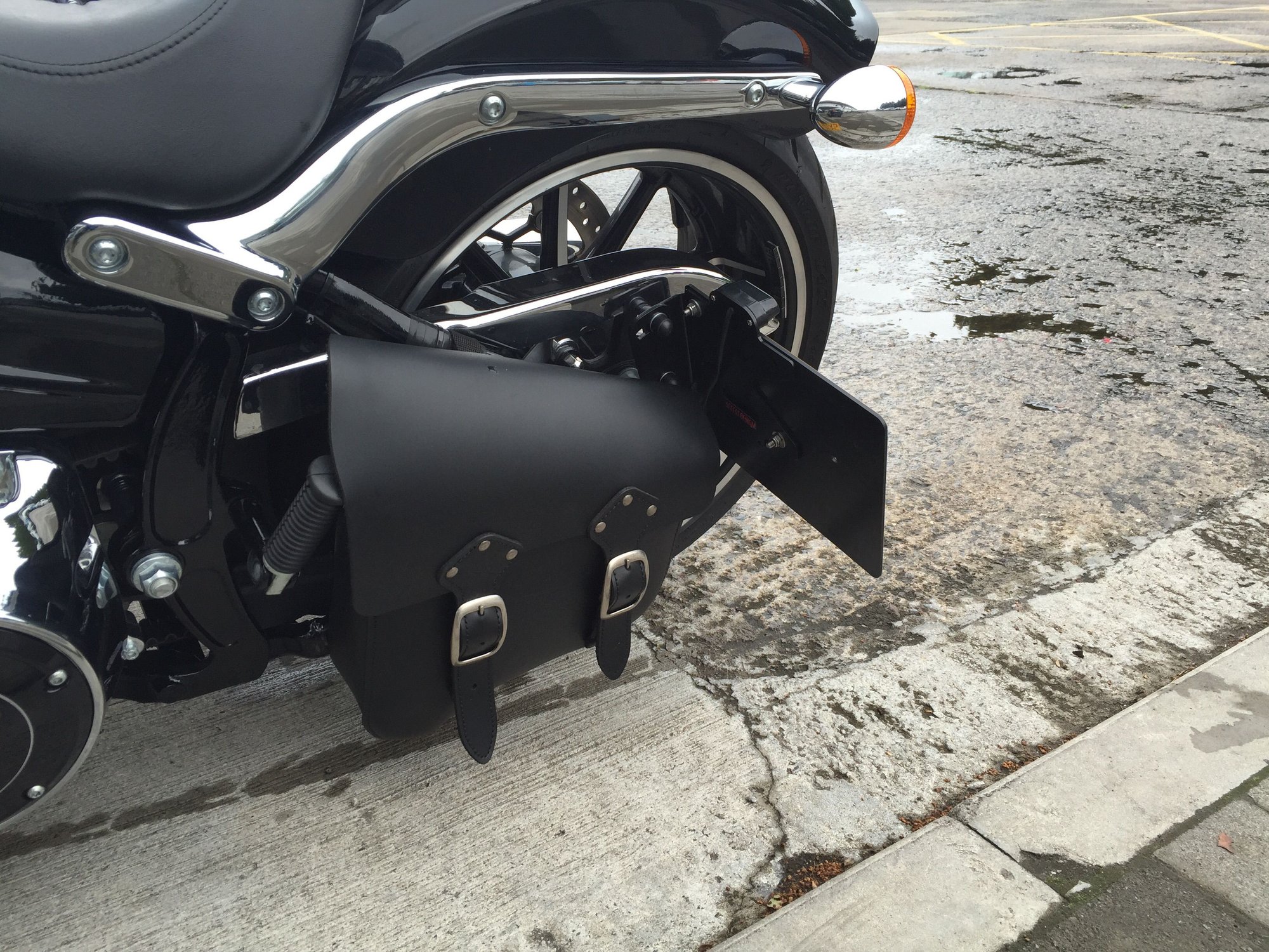

Different side mount to stock. I didn't like how high the stock one mounted.
Mounted on the axle instead of the washer. Dealer installed it at the first service for me and rerouted the wiring along the swingarm. The wiring is hidden well by the swingarm bag.

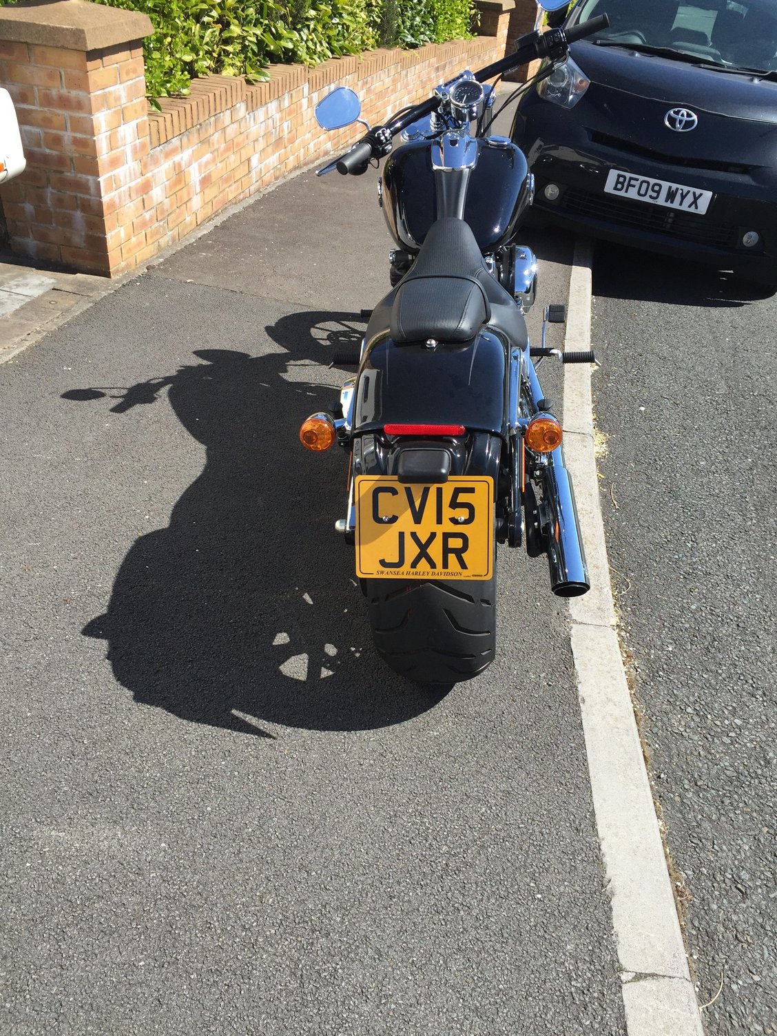

This was the stock UK mount. Ugly in my opinion.
Old post, I know...but I agree 100%, it IS ugly.
