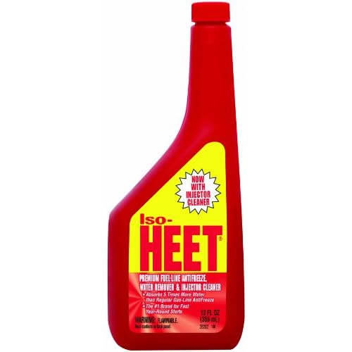

Sounds like bad gas. Been there, done that, have the ulcer to prove it. Go buy a red bottle of ISO Heet (or some other fuel injector cleaner/treatment) gas line anti-freeze or drain the tank if you can syphon it. Bad gas will make you think your bike is going belly up. If adding Heet and some fresh gas doesn't fix it, then worry about the FI system.
#1 Selling Gas-Line Antifreeze & Water Remover
ISO-HEETŽ brand is the #1 Selling Premium Fuel-line Antifreeze, Water Remover & Injector Cleaner. It absorbs 5 times more water than regular gas-line antifreeze, while it cleans fuel injectors and carburetors. It’s designed for use year-round in ALL 2-cycle and 4-cycle gasoline engines and diesel engines.

Funny thing is that I was thinking it was the gas and was on my way to fill the tank today when I thought I might not even make it! I haven't riden all that much and that is the same gas that has been in the tank since I bought the bike, but it is down to about 1/4 tank. I'll try the easy thing 1st and get Heet and fill the tank.
