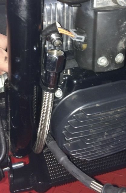

I have Oil Bud installed on my bike. It is really high quality product and becomes kind of invincible situated below the engine between the frame pipes. It is effective and I really didnt want to clutter my bike with clumsy oil cooler in front of engine.. so this was for me the only accpetable solution. These are not very common so was bit nerveous when I bought it as it is bit pricy but am really happy with it today.. I highly reccomend it.
here is a picture when installing it.. the front attachments havent been bolted yet so front end looks lower than final position
Thank you Helgi.
How do they mount to the frame? Did you have to drill anything?
