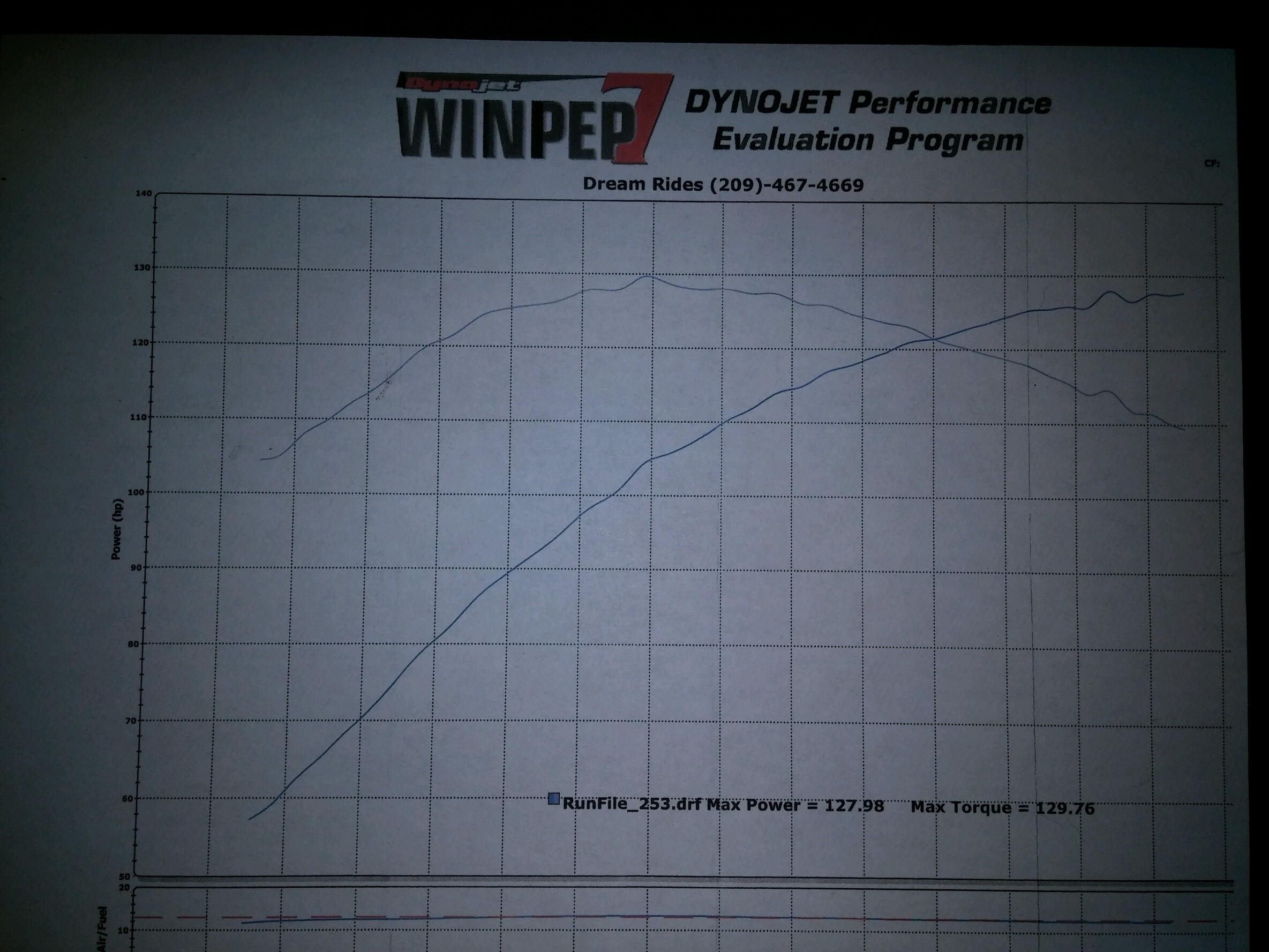

Thought I'd post this for anyone looking to do an s&s 124 kit , 124 inch kit out of the box as delivered. I haven't seen anyone do one in a breakout yet. This is the kit with 10.8 to 1 compression and 640 cams. I added the 58 mm se throttle body with 5.3 injectors from hpi. R&R overflow air cleaner, and used my same bobcat 2n1 pipe. Tuned with a powervision. I also added an oil cooler and a barnett scopion bullet clutch kit. California pump has friendly, and with minimum effort 15 more horse and torque could be had easily. Not needed imo.

Any Machining to the cases for that 124 kit? Any details on the process. Looking at upgrades down the line for my 110. A T124 would be nice but no B motor variants sadly from S&S in crate form
