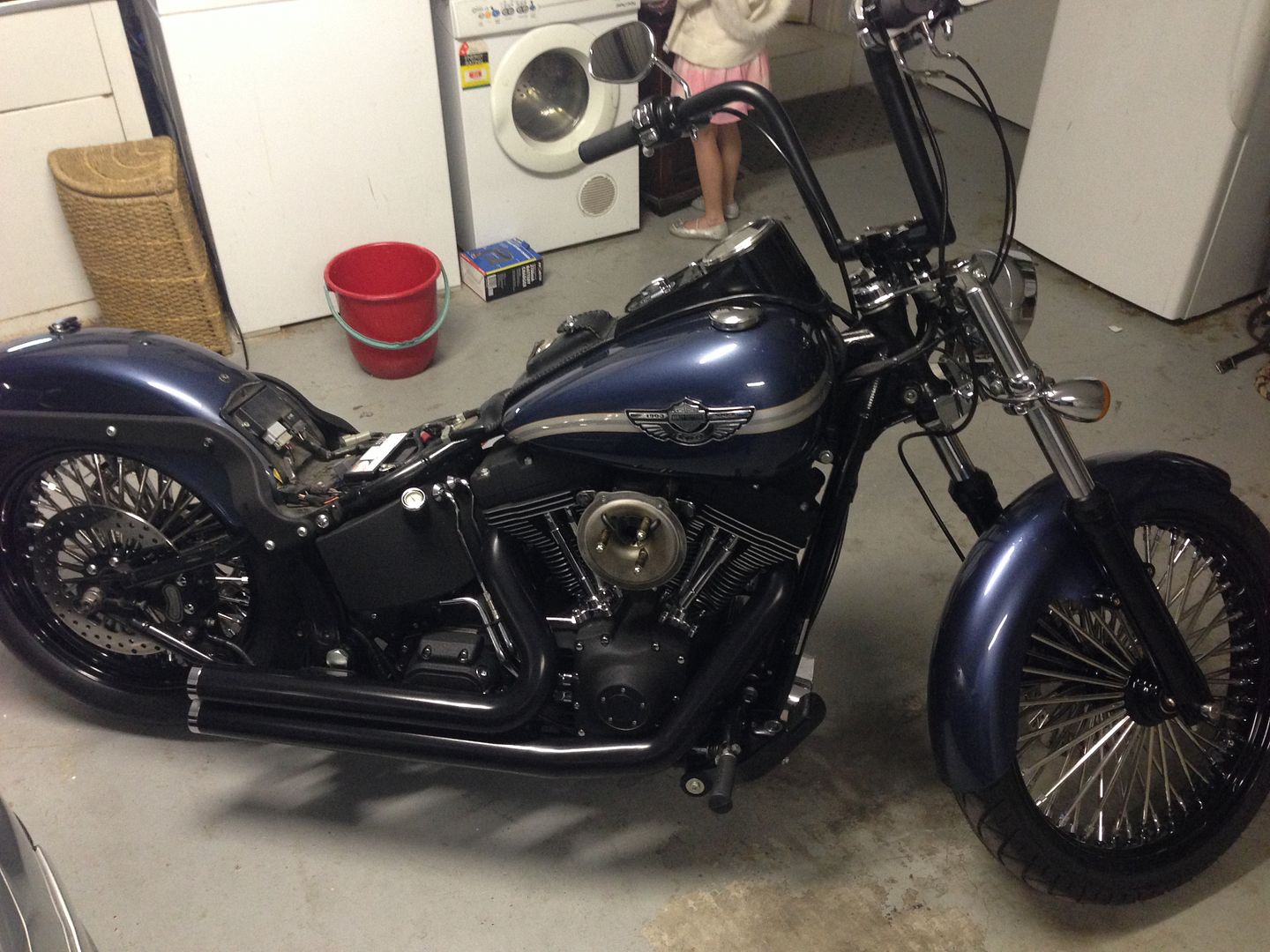

G'day all,
Can someone tell me if there is a procedure to follow when changing the battery on an 03
It will crank but I'm not getting spark & work start
When you go to start it the right indicator flashes???
It won't cancel when you hit the right button but will cancel when you hit the left?
The front indicators also stay on??
I'm guessing its an alarm issue??

For some reason the right indicator stays on (flashing) when I turn the ignition key
Any other thoughts??
