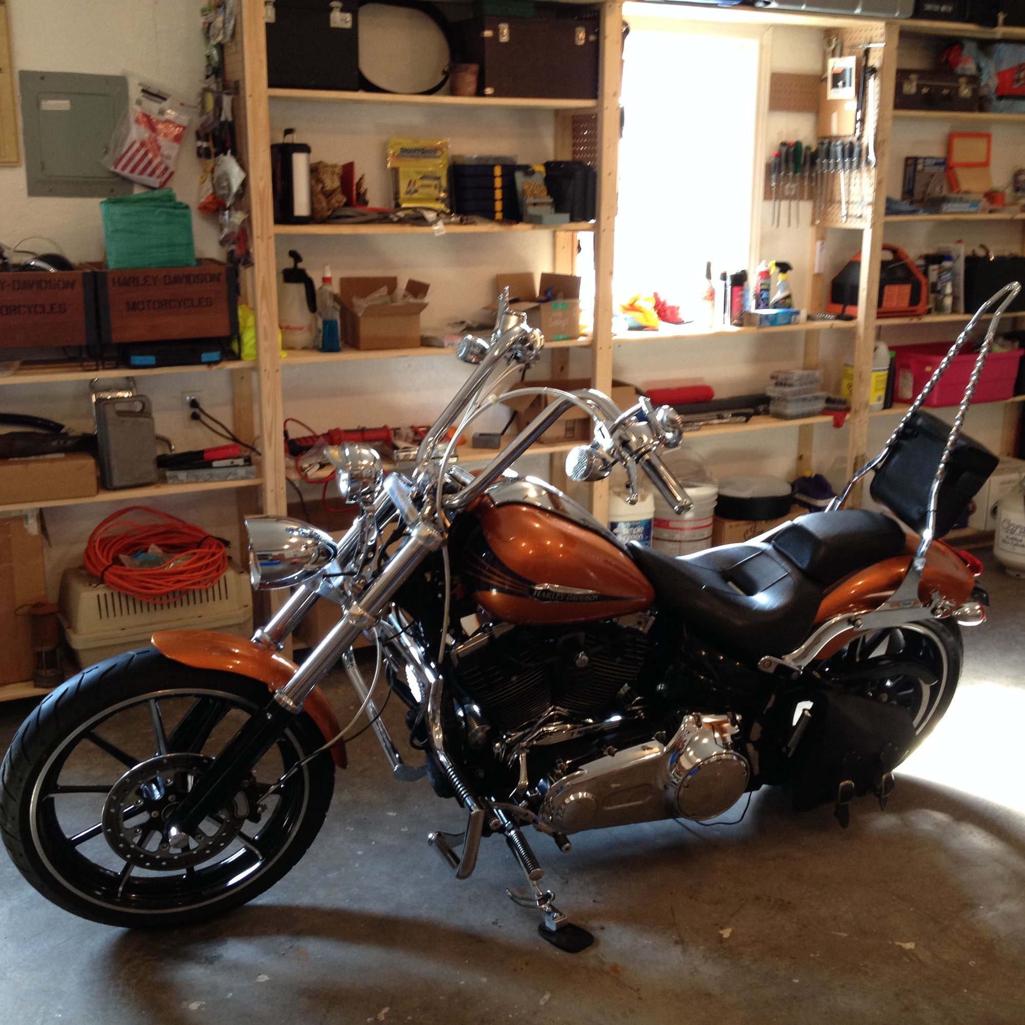

You mean one o these:
https://www.revzilla.com/motorcycle/...bar-for-harley
,,,,on one o these ?
Yep. Buy the QD assembly for the Harley Davidson one and just attach the "square tubed alternate bar to it. Make a spreader bar for the new assembly out of 2 x 4 so you don't loose control of it during mounting. These sissy bars are designed for 11" wide mounting and the BO is 13". You'll be dealing with a bit of springiness during the process and don't want to loose control of things and damage the paint on your rear fender.

What part number did you use for the QD. There are tons of them on the harley website. I like this set up. Looks sweet.
