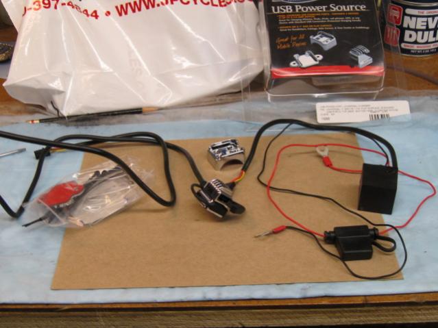

Last weekend I wired my dual USB power supply under my seat , not much space on a Deuce especially since my PC III resides there also. Considered a couple other spots but I wanted easy access to it and shoe horned it in .
I went this way because I wanted to keep the bulk down and didn't want to use a big cigarette style outlet that I'd just put a USB adapter in anyway, going for the least conspicuous look I could.
I ran the output line up the frame back bone and will post pic's when I decide on the final mounting point for the USB port. Got to finish my handlebars and signal relocation 1st though.
