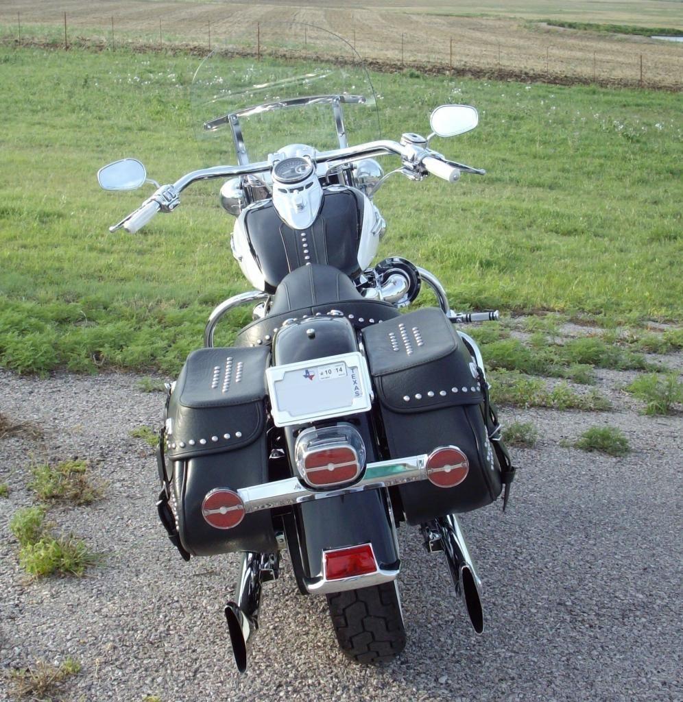

i ordered them from Samson and had old fort Harley in fort smith Arkansas put them on. i didn't notice they were off till a few days later. i haven't seen any others off like this. there more noticeable when the bike is vertical.

I'm unable to tell from your photo, and I may be incorrect, but there should be a header pipe and a separate Tail pipe. You should be able to loosen the brackets and clamps and adjust the two (Left and Right) Tail pipes so that their orientation matches each other.

I don't know much about the fish tails, but it looks like the left pipe end is installed upside down? Is that possible?

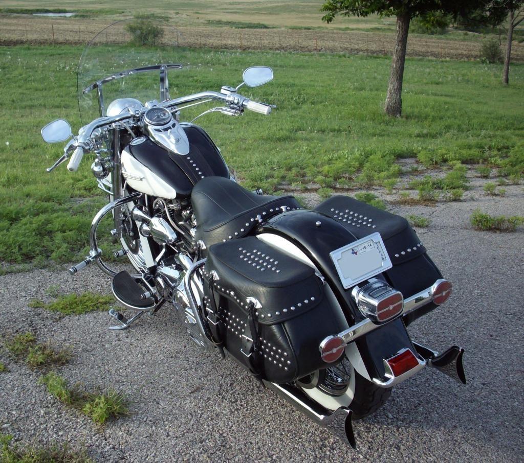

I would return to the dealer and advise them of the problem. Here are my 28.5's on a 2012 Heritage.
Originally Posted by Mikula
just another reason samson has a bad reputation. unbelievable.
Although Samson has had their share of problems of late, this is an installation issue, not a Samson one.

I installed my 42s this weekend and had the same exact problem. If you look carefully, you'll see your left bracket hanging lower where the pipes bolts on.
Last night I took off the heat shields. loosened the clamps, and pushed up on the left pipe and it all fell into place.
You just have to work with them to get them lined up.
Like Bone Doc says, it's an installation problem, not a Samson problem.

I installed mine and had to adjust them with the bolts loosened until they lined up. Then I tightened the bolts. It looks like your dealer just slapped them on and tightened them up and said it was good to go. I love my Samsons.

That's nothing to do with the brand.
Loosen the bolts straighten the pipe then tighten the bolts back down.
