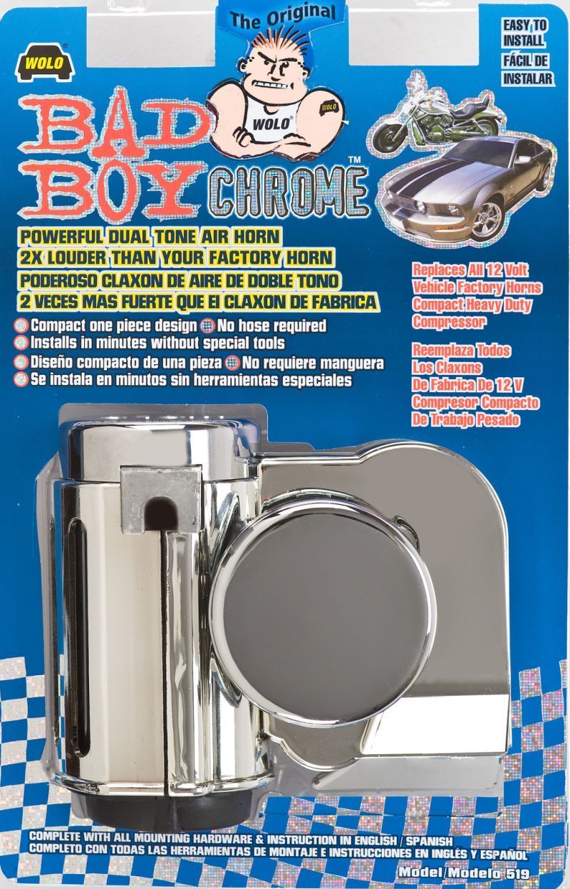

Got me one of these. Lots louder than stock. Mounted it in roughly the stock location, needed to make a simple bracket. Stock wires plugged right in... didn't use a relay, hasn't fried the horn switch yet after a couple of years use. About $60 in the chrome version.
Cover it with a plastic bag if you pressure wash, or it won't be happy.

I'd guess it would work fine. I don't know whether it or the Wolo is louder. Did some testing with a decibel meter on a few things, but didn't include the Fiamm. What I found is that decibel claims are mostly crap. Not that anyone in particular is outright fibbing, but most don't include the actual test conditions, like how far the decibel meter was from the horn, and whether it was in an open field or a garage.
Personally, I think the sound of a two-tone air horn is more attention-getting.
Photo of the Wolo, mounted on the bike in front of the downtubes:
