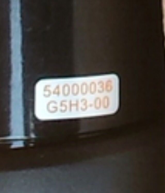

Hey guys, I know someone that has these up for sale which are off a 2014 road king with 5k mi. on them. Do you guys think they will fit on my 2014 Iron. 13" eye to eye with a lowering bracket. I didn't see this part no. in wachukos list.
they will fit yes - my shocks are 13" as well i have adjustable 1 to 3 inch lower blocks/plates ,, i have them set to lower 3 inch .. i have the lowerd look i want , and yet i still have the full range of motion from the longer shock .
it works perfect for me - if u look in this thread i think i posted pix of mine on the scoot and u can see the angle they sit, some people here like it some people hate the look , i love the look , it look more inline with the rest of the lines of the bike now and ride way awsome..

I saw in here that there might be a need to adjust the tension of the belt did you guys have to do that being that you had the 13" shocks installed?
