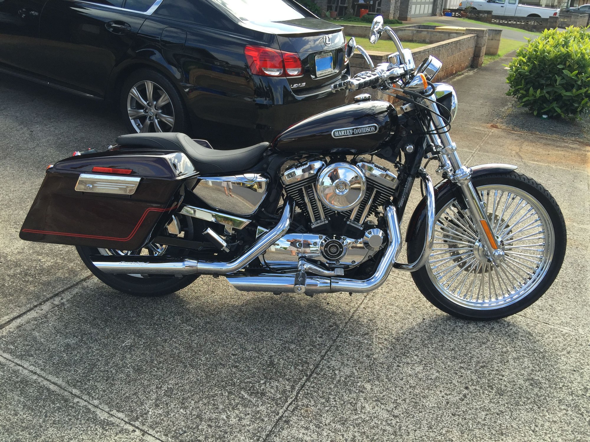

I had SEIIs on my 2011 Sportsters Low XL1200L and it fit perfectly. Crossover ports were on the slip-ons. Not sure about the part number. HD stopped selling SEIIs in July 2006. They sounded and performed great.
With respect to tuning...as mentioned, if you have stage 1 AC, it is probably a good idea to tune your bike so it doesn't run hot.
Here is a pic of the SEIIs
