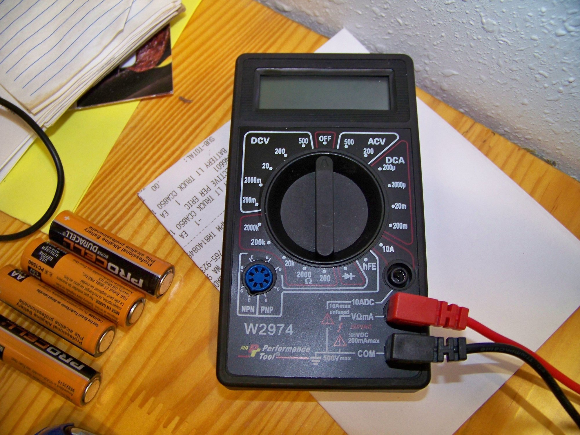

Finally getting back to bike. Here is a pic of meter I picked up.
