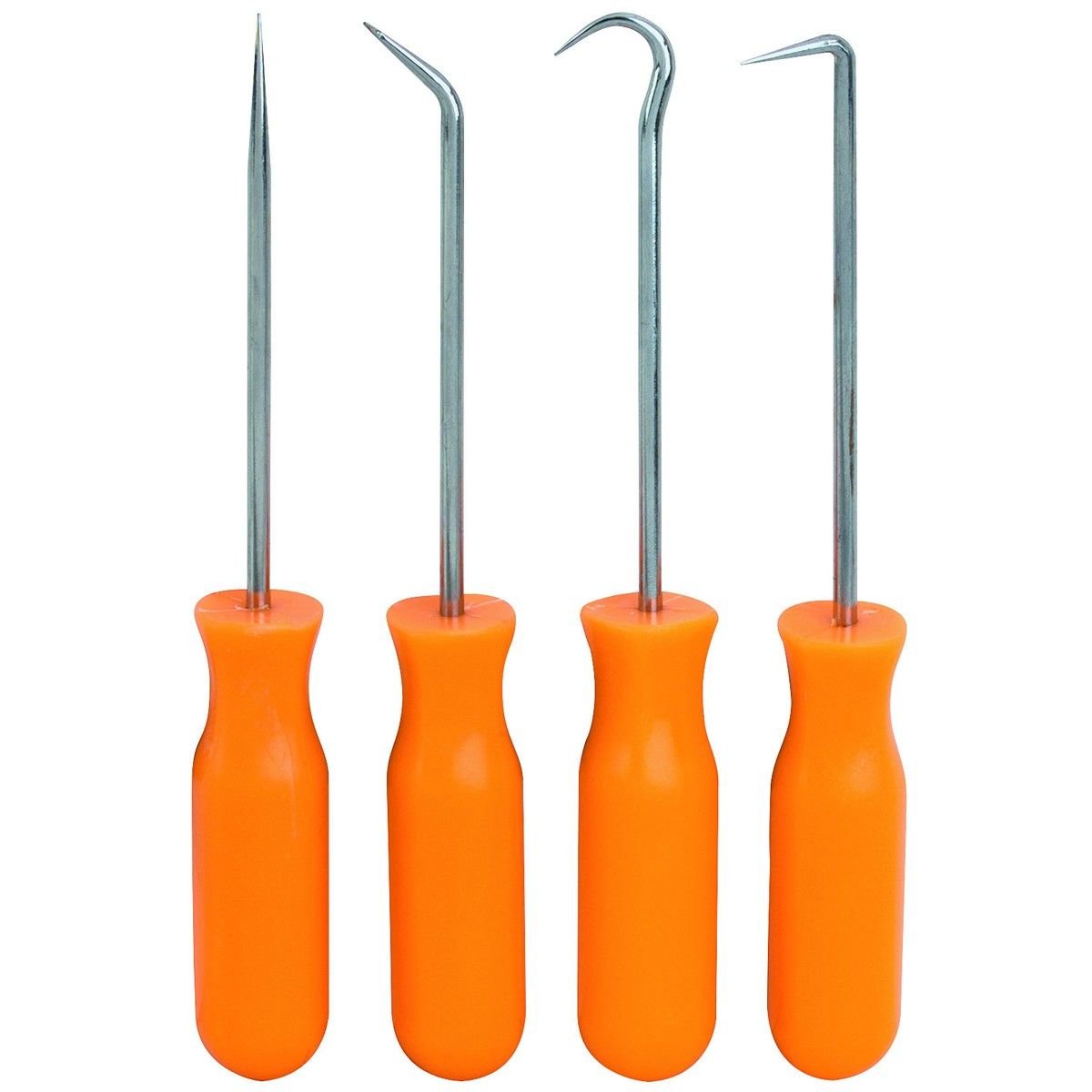

tip #1: do not try to install in the cold. headaches and tear will follow if you do.
tip #2:
http://www.harborfreight.com/4-piece...set-66836.html
