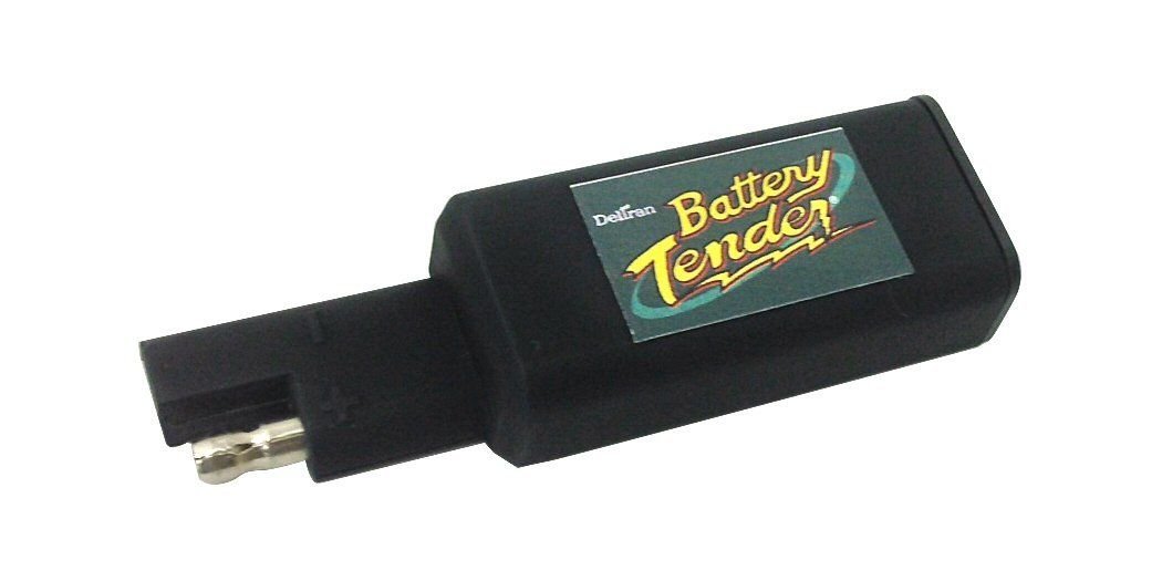

Amazon.com: Battery Tender 081-0158 Black Quick Disconnect Plug with USB Charger: Automotive Amazon.com: Battery Tender 081-0158 Black Quick Disconnect Plug with USB Charger: Automotive
or bend over for this:
http://www.harley-davidson.com/store...FdgQgQodc58Ihw
Both power directly from the battery
i bent over. by accident
