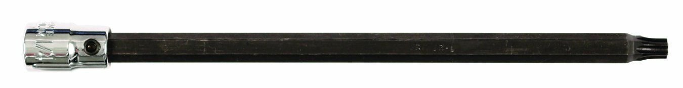

That one screw right by the damn peg bracket?
Yeah need a long torx or something. Or take the peg bracket off I guess. I just semi-****ed up that screw the other day, going to need to replace it.
Probably need one of these and an impact driver to get it out if it's really ****ed up. You can get hand impact drivers, don't need a gun
