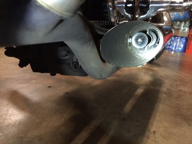

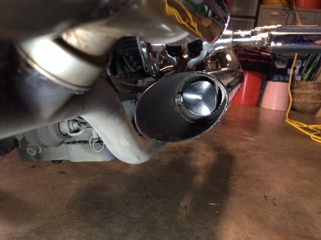

I have 3" rush with 2" baffles and the 158 was too small and the 258 fits tight but quiets down the pipes too much and was unable to turn the cone much (baffles were too close) to open the gap.
The 158s should work fine with your 2". I had a 2" exhaust and the 158s worked great....better tone and smoothed out the gaps in the powerband.
Here is aa pic of the 118 in a 2" exhaust...you will see there is too much gap around the cone
Here is a pic of the 158 in a 2" pipe....fits perfectly with proper gap around the cone.
