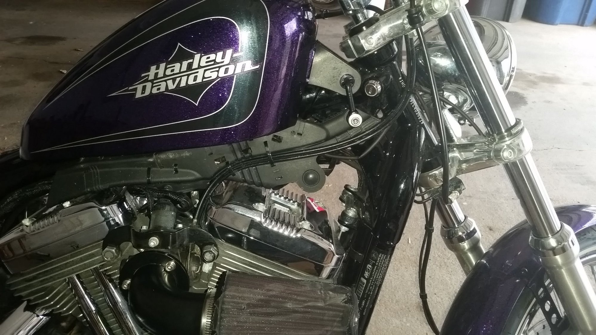

Finally got my coil/key relo done along w/ the tank lift and speedometer relo. I think it looks good but could be better
My question for anyone who has done the kit, what did you do w/ the wires and/or plastic piece. Right now I have the plastic piece there as it hides the wires, but I think it looks awkward, I just don't know what to do w/ all the wires. Ideas? Images?
Thanks

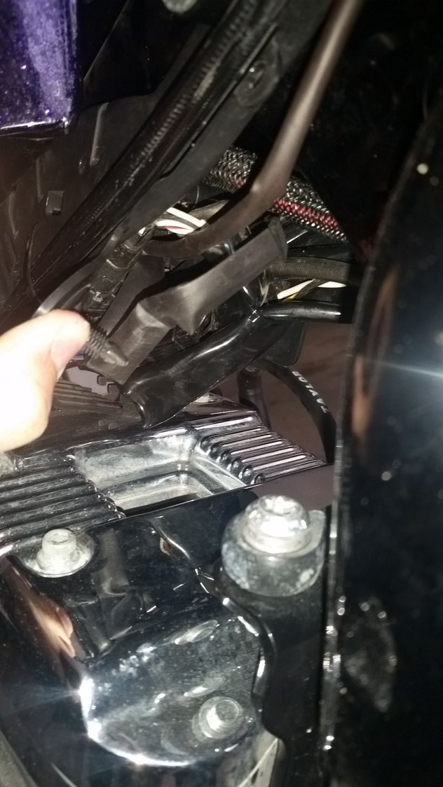

Originally Posted by GbarIV
Very curious myself! Im thinking that the wires your speaking of are the wires "typically" tucked under the tank with the space created from the tank lift?
The plastic piece I'm not to certain on purpose but see alot of bikes with this removed, my guess is once the wires are tucked, this wouldn't be needed?
Here's me trying to get a pic, and notice the plastic piece runs all the way down the tank (first image)
It just seems like there's a nest of wires that would be visible if that piece wasnt there
oh wow, that is quite the nest!
