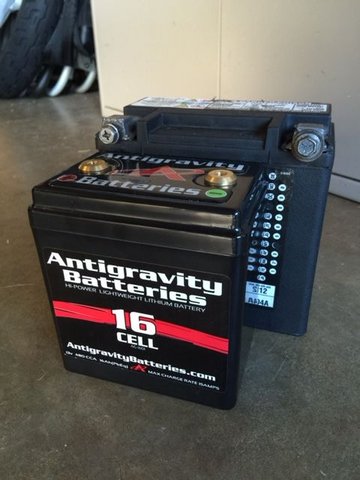

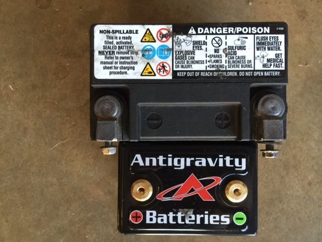

I have the Antigravity 480CCA 16 cell Lithium....starts right up without hesitation that my stock battery had. Smaller and lighter. There is a 600CCA but I think that's overkill for a sporty. Here is the link.
http://www.dkcustomproducts.com/Batteries_c91.htm
