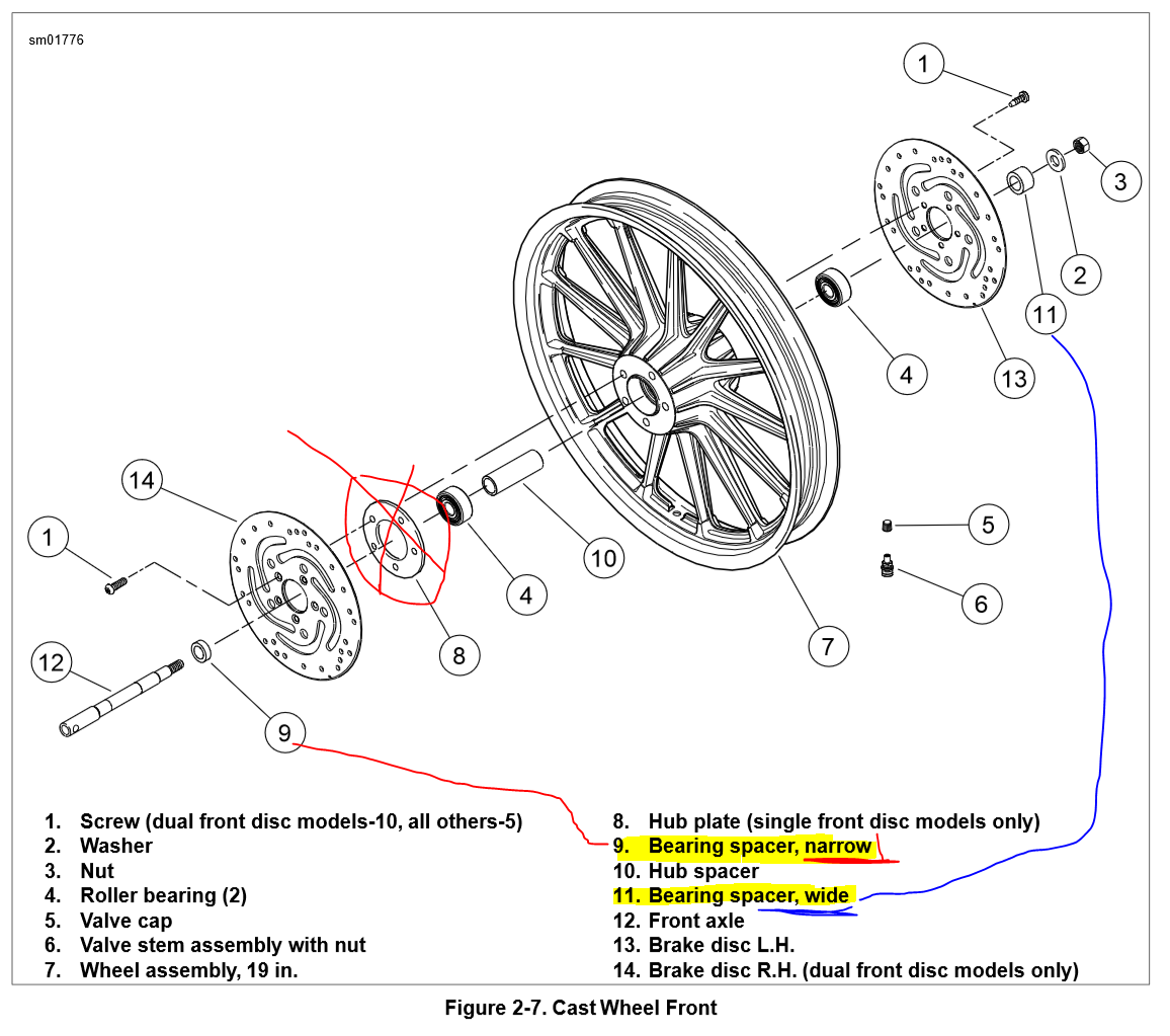

I'm really stuck... I removed my wheels fro my 2012 iron to have white walls fitted and wheels powder coated. I had new bearings fitted also. Problem I've got is when I refit the front wheel the bolt heads from the cover on right side of wheel incase it had dual discs rub on the inside of forks? I have the spacers the correct way round ( larger spacer disc side). The bearings appear to be fitted correctly so just can't work out what is happening? Also when I put brake calliper back on it binds so something is defo out of alignment. I really stuck and bikes stuck on stand so can't even take it anywhere.

Have you got the disc on the correct side of the wheel? I ask cuz I've seen it in here.

you more than likely have the spacers on the wrong sides or maybe have #8 (below) still on the wheel. like i said i dont see your conversion in here. if #8 is still on the wheel, it will prevent the right side rotor from sitting in the slightly recessed groove and it & it's hardware will sit out further than it should.

It's an iron so single disc, the cover #8 is on the wheel as standard and I have not removed/refitted it and it's the bolts for it #1 that are slightly rubbing on the inner forks. I have put wheel into place, slid axle bolt through with both spacers (larger one disc side as per diagram) then torqued up axle and when I spin the wheel the bolt heads #1 rub on forks, brake calliper is still off at this point but did try to refit and brakes were binding? Cheers for replies guys 👍🏻

Just found a post that might explain it. It says to pull fork out with a 7/8 drill bit in the axle hole till the fork just touches it then do up pinch bolt, I never pulled fork out just done up pinch bolt where it was? So maybe if it moves 1-2mm it will clear bolt heads?

you mean the service manual instructions?
