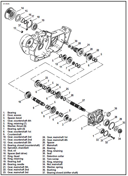

Here's the power flow through the trans in first:
The power comes in through the mainshaft (upper left), goes into the 1st mainshaft gear (which is splined to the mainshaft), flows to the 1st countershaft gear (which floats on the countershaft). 1st counter is engaged via dogs with 3rd counter, and 3rd counter is splined to the countershaft. The power then flows out 5th counter and main to the final drive pulley.
So the dogs that are involved when you're in 1st gear are the ones on the 1st counter and the 3rd counter gears. Those are probably the gears that need to be replaced, assuming the issue is momentary hop-out.
Here's the big picture for the trans:
1st counter is number 8 and it's part number is 35763-89A
3rd counter is number 10 and it's part number is 35771-94
Check me on those part numbers to be sure.
Safest thing to do would be to pull it apart and verify those dogs are worn before buying new gears. But if you're dealing with momentary hop out, this is the common cause.
