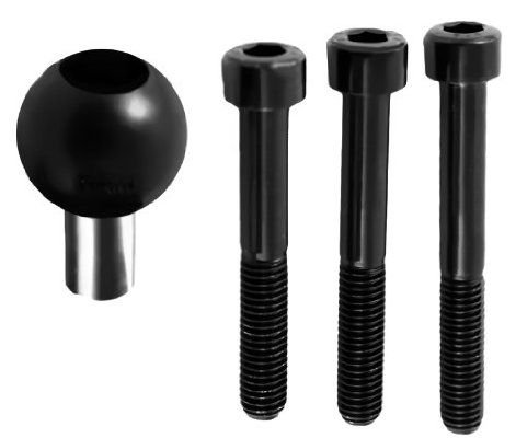

The bike is a 2011 Forty-Eight. I want to use a RAM bar clamp mount but it comes with M8 bolts and in searching the web I've found multiple answers so I want to make sure I buy the right bolts the first time.
Can anybody tell me what size the bolts are? The mount comes with:
(1 QTY) M8 x 55 bolt (1.25 thread pitch)
(1 QTY) M8 x 60 bolt (1.25 thread pitch)
(1 QTY) M8 x 65 bolt (1.25 thread pitch)

Ok so now that I should be able to post pics I'll post what I'm talking about.
The answer to the question about the clamp bolt size is 5/16-18.
Here is a couple pics...
The mount on the bike.
The mount... These bolts don't fit.

That's better, now I understand! I use one similar to that (different brand) on my Buell. You need an American threaded screw, 5/16" x 18 tpi, not the metric ones you seem to have. They are similar in diameter to each other, but with the correct thread. As for length, you'll have to work that out I'm afraid, although that should be pretty easy. The tip of the stock screw probably reaches the bottom of the threaded hole it fits into, which you can confirm by looking up at the front right-hand one. Your new screw needs to reach that far, with the ball and spacer etc in place.
As a point of interest, depending on what you use the ball for, you may find your speedo is partly obscured. I found that installing my ball on the right-hand side was better, so I could see the lower speeds on my speedo.
Hope that all helps!

5/16-18 thread, 2 1/4” Allen head
what kind of bike? Originally, I bought the standard size arm and ended up being too long to fit well within the bit well keystone bars. Then bought the 1” short arm and fits perfectly.
