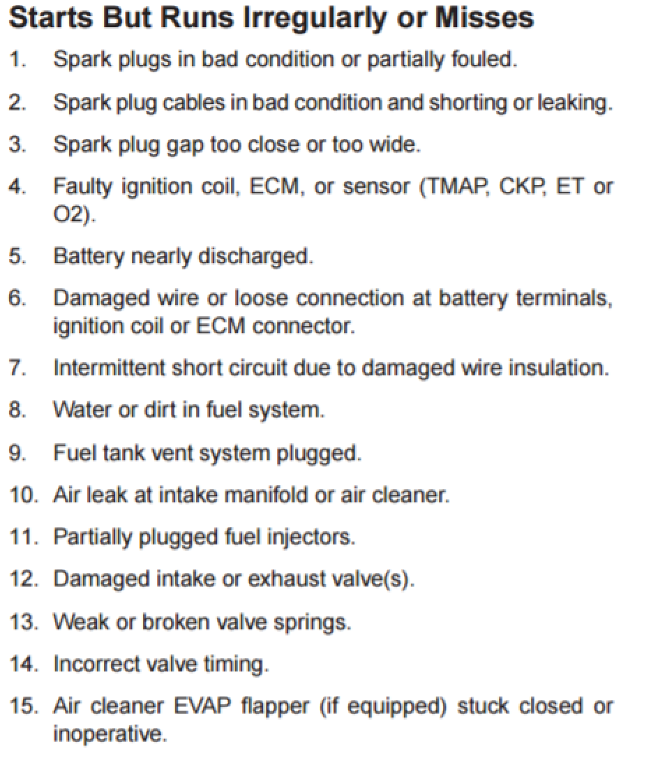

yes, but so can dirty contacts, loose contacts, dirty/failing sensors, dirty air cleaner elements, etc...
air, fuel, and spark: keep those guys clean and in good order.
Air:
inspect and if needed, clean/replace air filter element. oil and debris can reduce the optimal air flow.
fuel:
most will say that modern gas has all the detergents needed but, run some seafom or startron through every now and then. since you have a 2013 efi... that's kinda where it ends unless you have pump issues, which you more than likely do not.
spark:
check all connections and ground points. keep battery on some sort of charge with a battery tender being preferred. check you bike, in front of the battery area for an sae charging lead:
https://www.hdforums.com/forum/sport...ignorance.html
if there is one there, grab a tender and use that lead to charge you bike when you aren't on it and to keep your battery healthy.
if there is NOT one there. you can get a lead cheap:
https://www.amazon.com/2-Pin-Battery...e+battery+lead
or get one with an indicator that tell you you are low and need a charge/have an issue:
http://www.harley-davidson.com/store...arge-indicator
a tender jr is all you need and they have long cables...
https://www.walmart.com/search/?query=deltran
fun times
-from service manual
