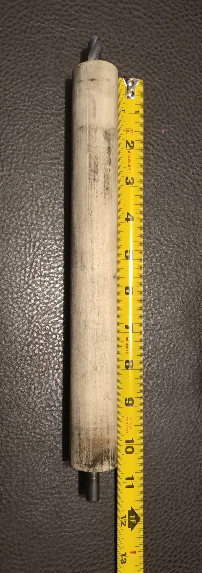

I did this on my '08 1200R. There is a solid baffle plate about 10" in. First I got a 1 1/4" wooden dowel, drilled a 3/8" hole down the center of the dowel on a drill press. Now you have a guide, to prevent drill drift, and keep the hole properly centered. I started out with a 3/8" hole. I used a magnetic telescoping tool to retrieve the metal shavings. I rode around a bit...still too quiet. I then drilled it out again to 1/2"...still too quiet. (By the way, you'll need some long bits to reach the baffle). I re-drilled it out again with a 3/4" bit. I was happy with this, plus there is still quite a bit of the baffle left to give some back pressure. It is louder than stock, with a percussive quality to it, but quieter than most aftermarket pipes. I prefer the look of the stock pipes myself, that's the reason behind this. I also changed out the air cleaner to a Performance Machine, so I got a dynotune via my SE supertuner. There is some significant vibration felt thru the pegs at around 3200 rpms, but I've lived with it for a long time, no big deal. This is my experience.
Drilled out dowel rod as a guide
