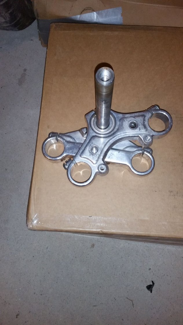

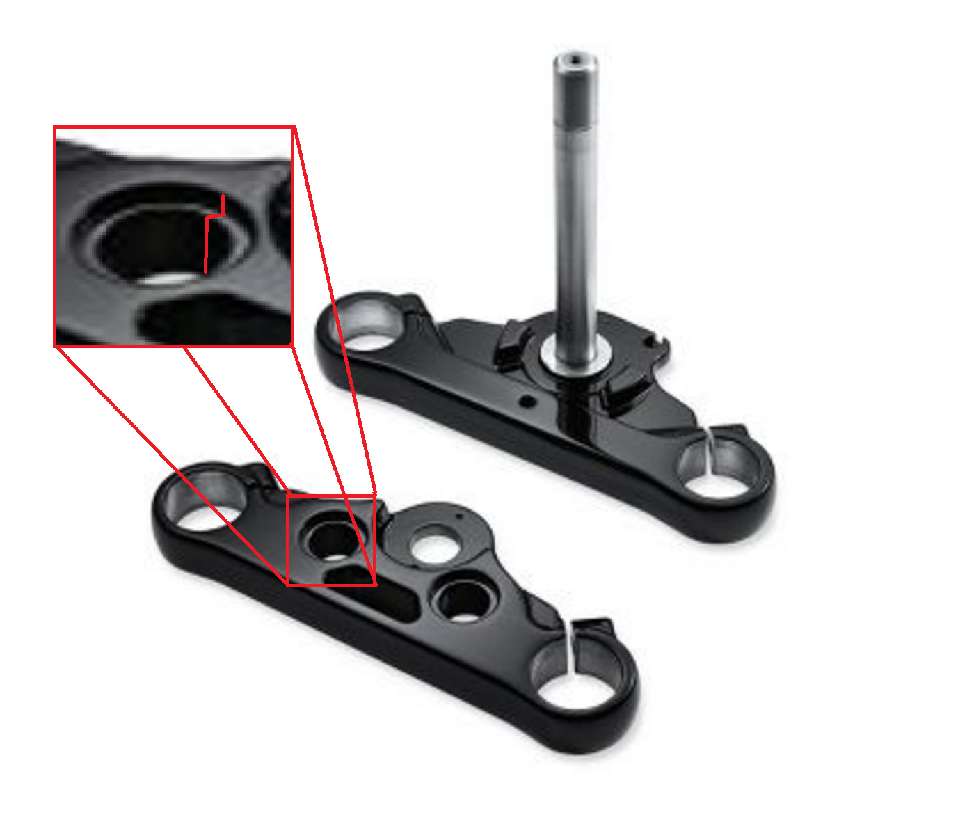

Originally Posted by Søren Rix Petersen
superlow trippel not fitted yet, std Iron has risers that can be changede so there is rubber that could be changede
Regards Sören
no rubber in there man. the iron uses basically the same trees as my old narrow glide front end.
if it supported bushings, you'd see huge stepped round gaps instead of the small bolt holes above:
http://www.harley-davidson.com/store...-04-4860909--1
more info here:
https://www.hdforums.com/forum/dyna-...l#post15125572
i think i should have used street bob-ish trees and gone 49mm when i did my conversion. i would not be trying to hide wires now. would have introduced new problems though... fenders and such

No Rubber bushings since rubber mounted engine (2004)
You could have your tree machined for the bushings if desired or (without me confirming all dimensions) you might be able to swap for 2003-earlier top tree
