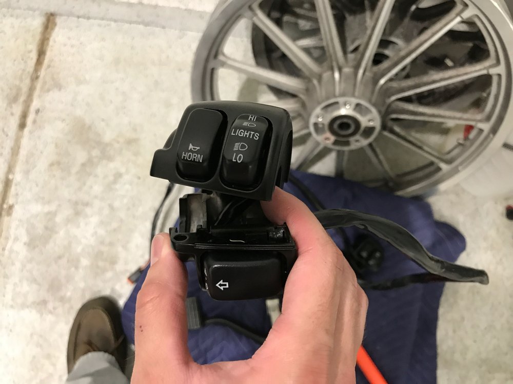

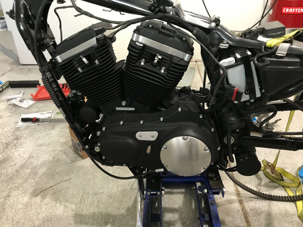

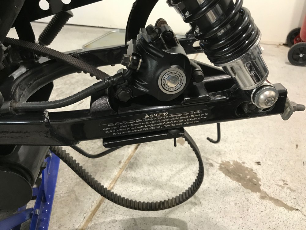

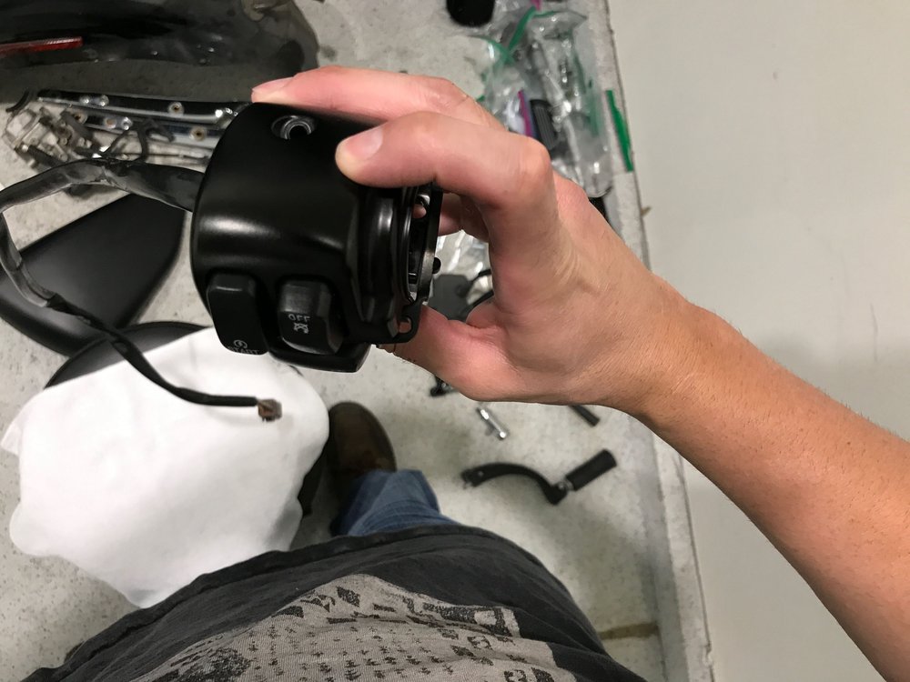

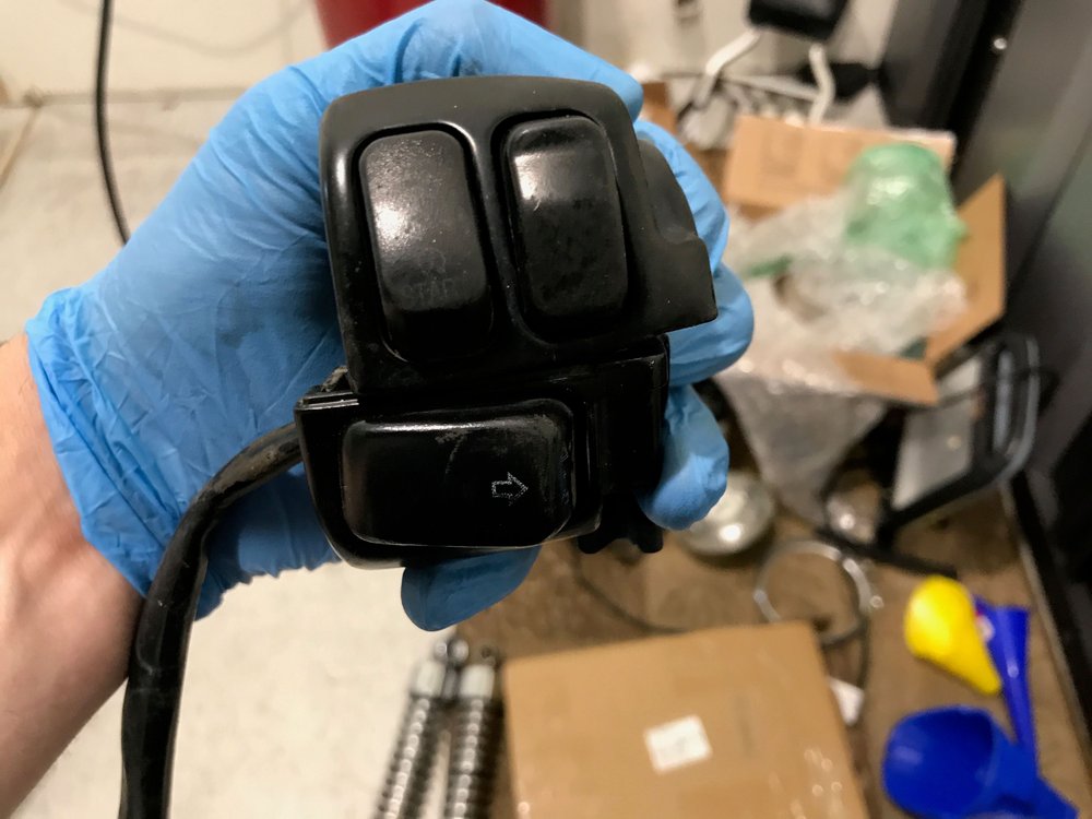

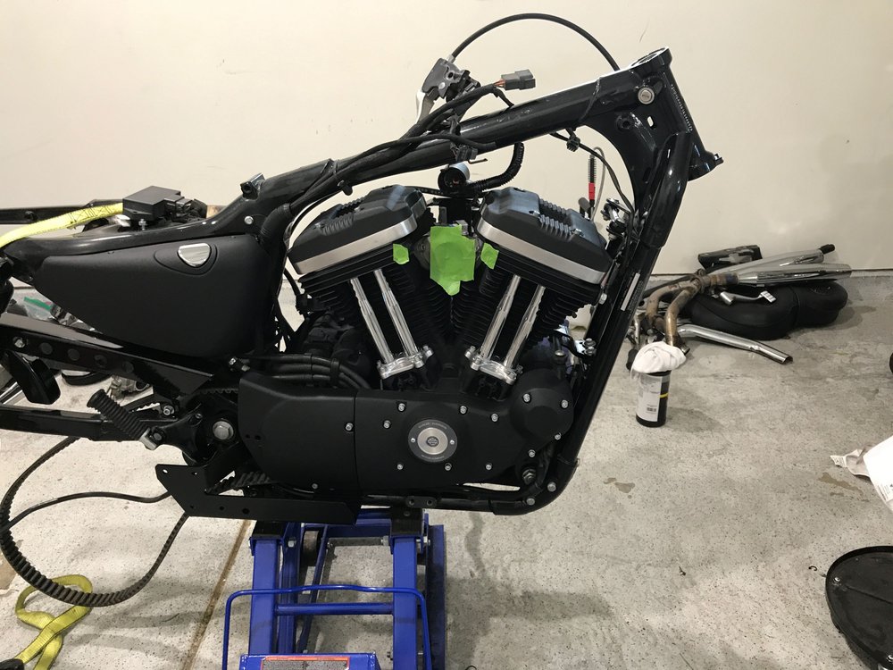

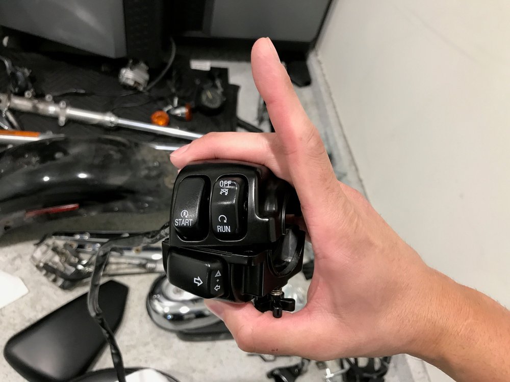

Little bit of work done today. Took longer than expected. Stupid in/lbs torque wrench broke, so I had to pick up a new one. Plus the brake lever I got was missing the internal bushing so it's all floppy on the peg. Had to order that from Harley. Oh well. Anyway, pics below:
Right hand control housing and buttons replaced:
Before...
After...
Thing is so fenagley but got it done. Then replaced all of the bolts on Cam and Primary covers:

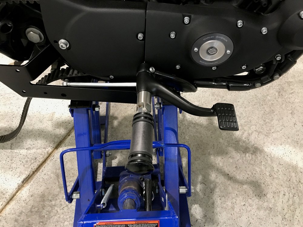

Also replaced belt guard with "bullet hole" guard and new rear shocks from a Nightster (will drop it about 2.5 inches)...

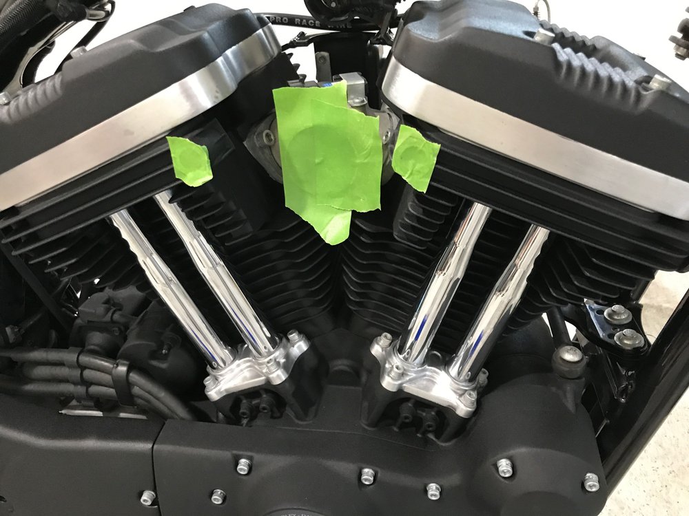

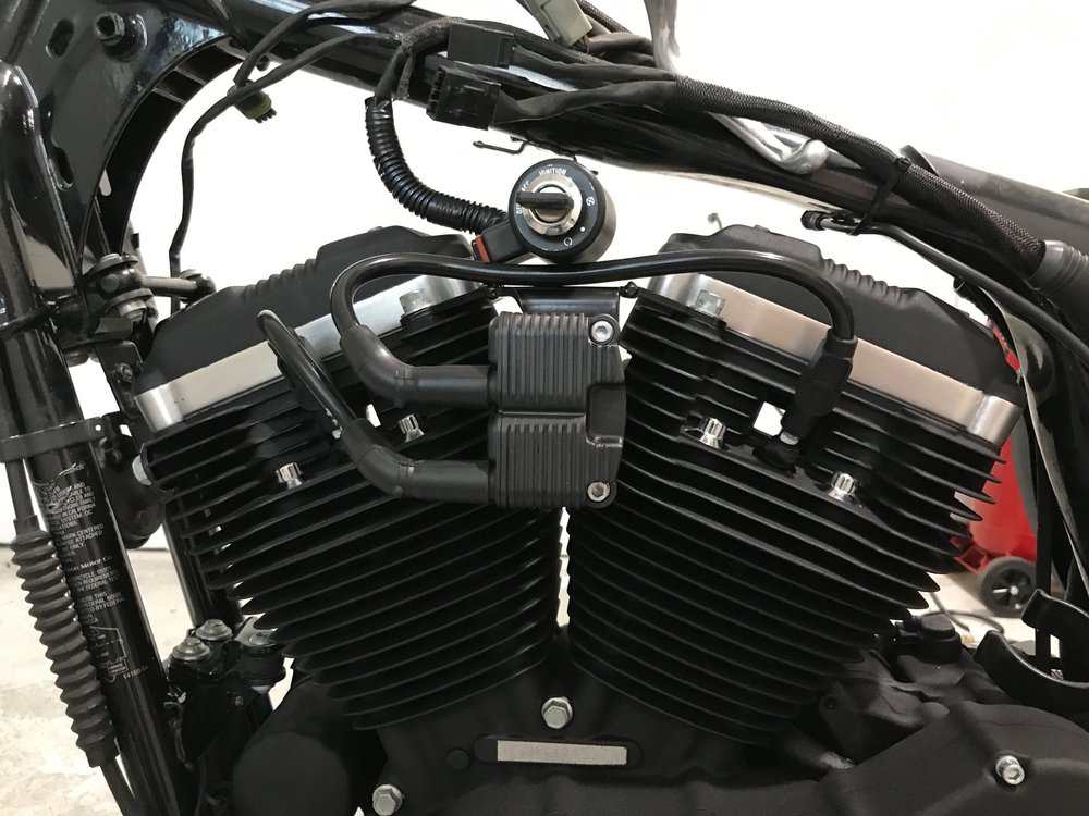

Put the coil and ignition relocation kit on and the new cables. I think I cut them a little too short, but oh well. Oh and there's NO way that the petcock and the ignition relocation will work together. I've emailed DK Customs to see if I can get the other kit that mounts it behind the rear cylinder.
Also got the intake manifold mounted back up with new rubber washers. The ones on there were falling apart!
Also got the front sprocket guard mounted back up. Looks good.

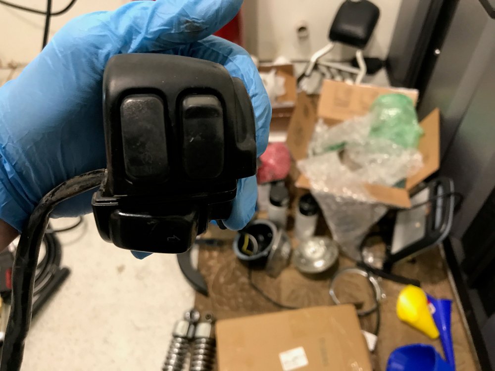

One more thing done, finished swapping over the left side controls to the new housing and with the new switch covers. Looks new!

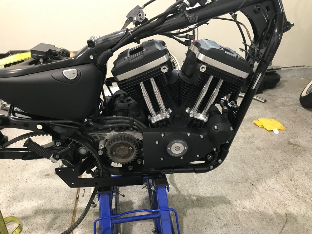

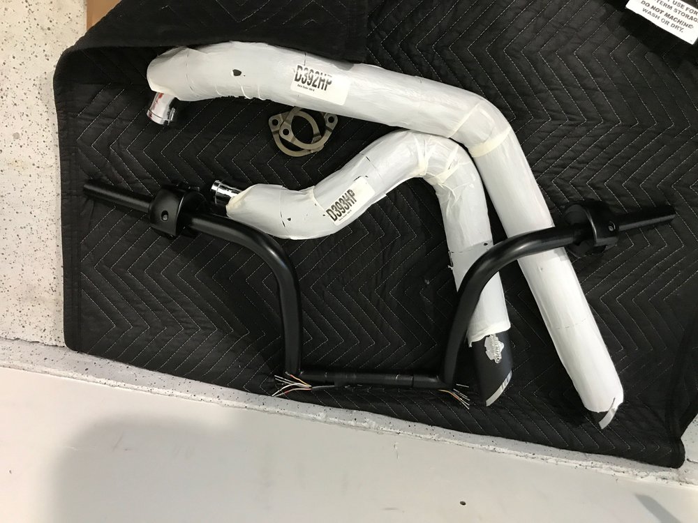

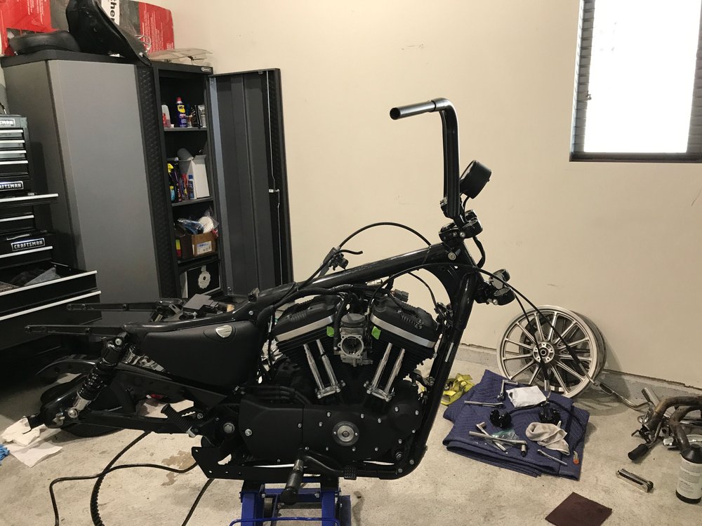

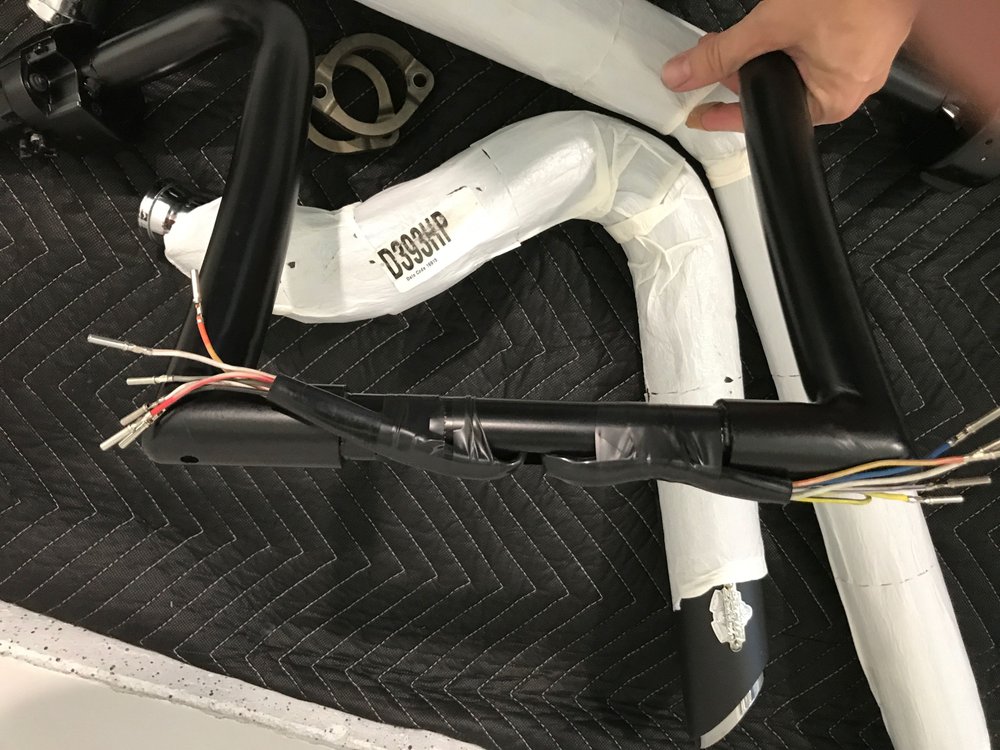

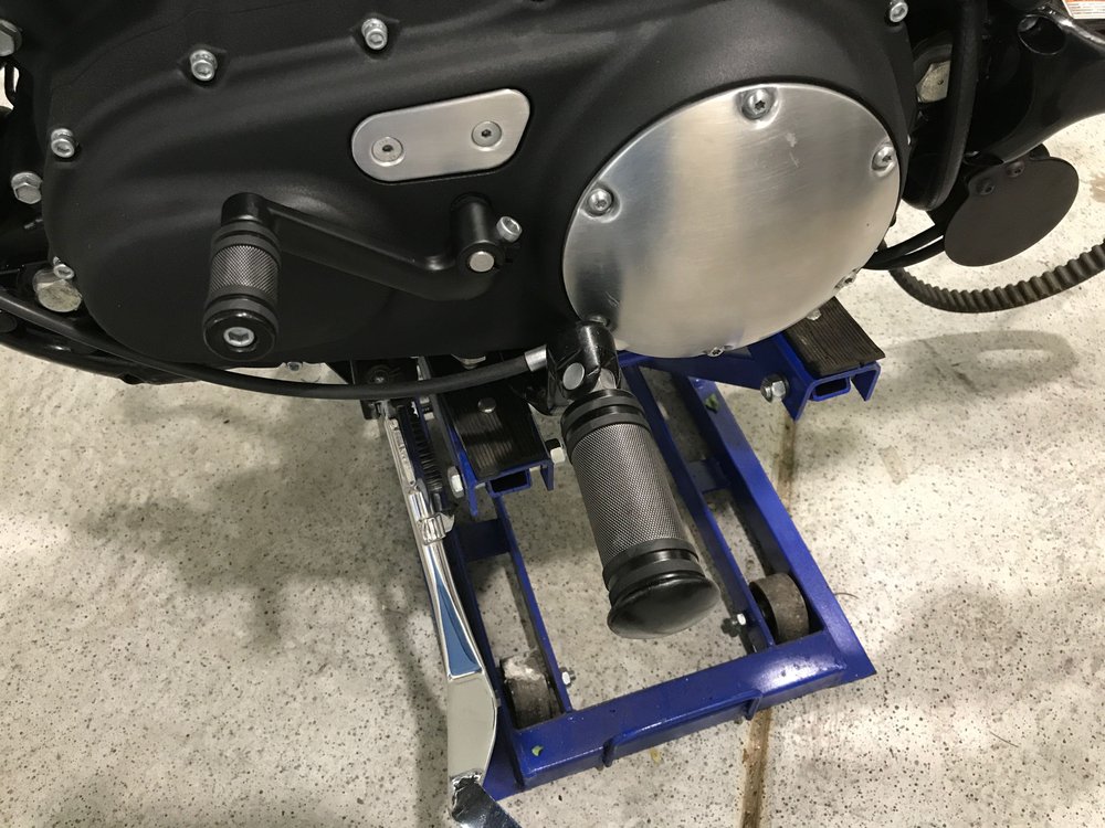

Got some stuff today and split out the parts that are going to paint vs the parts going to powder. I'm surprised that there's not more, but then again I just bought some parts so that I wouldn't have to. Anyway I was out there for about 6 hours and it doesn't seem like much, but good progress. It took me about 3 1/2 hours to run the wires through the handlebars... not too bad considering what I've heard others say (~8 hrs). Going to get wiring, clutch, and throttle cables now that I've checked lengths. Love these bars by the way. They are SICK! Anyway, pics below:
Bars mocked up:
Right foot controls back together:
Left foot controls put back together with new shifter:
New BLACK rear brake:
Handlebar wiring run:
Yeah, I taped them down so they wouldn't accidentally run back through. Probably unnecessary, but after all that work the last thing I want is having to do it again...
Also, this is the THIRD time I've tried to put the exhaust on. This time I was fouled up by a bent circlet off the original pipes. I should have checked. Looks like a drive down to Harley to get 2 new ones. Stupid...
