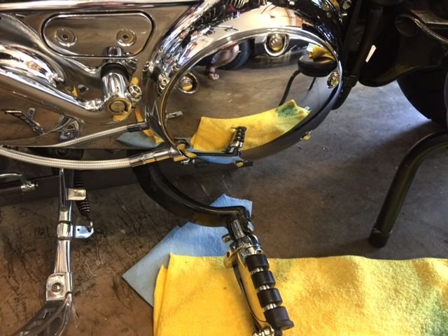

3. Remove right side shifter peg mounting bolt and loosen the left side – the right side will swing down out of the way.

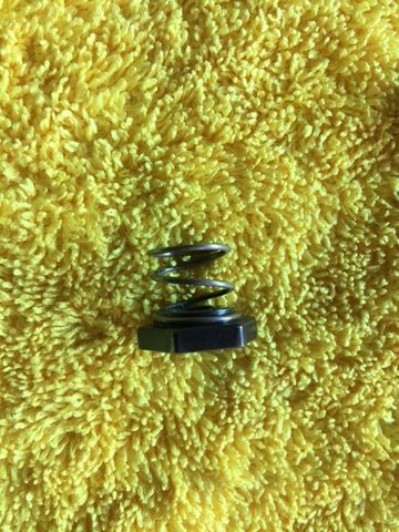

5. Pull the outer lock nut with spring making a mental note on how the lock nut aligns to the adjustment screw.

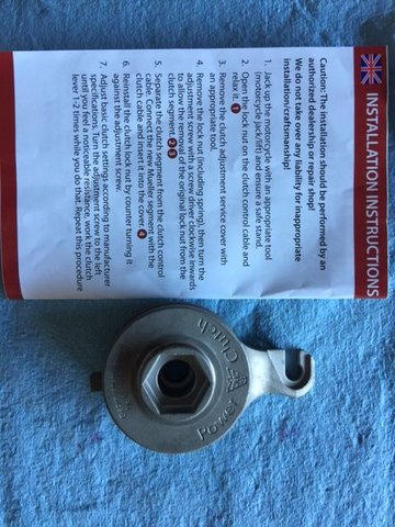

10. Install the Muller Power Clutch by hooking the cable and inserting the inner and outer ramps

Here are pics of the outer lock nut and spring and a pic of the Muller power clutch installed.
