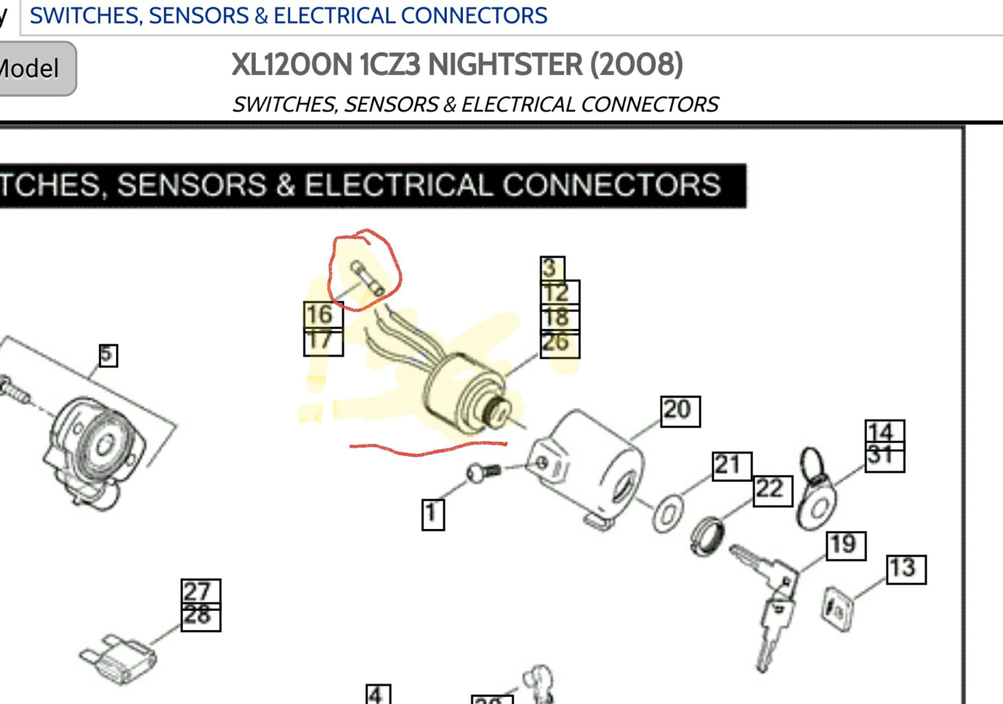

I belive the ignition switch is bad. I want to replace it but it looks hardwired. If i cut it, the wites may be too short. Do new switches come with extra wires?

That sort if depends on the year of the bike and thats an ignition switch not an ignition. On newer ones there is a quick disconnect. That doesn't look like an newer bike but, it may be. No idea. Seach here by bike: http://shop.outpostalaska.com/OEMpartfinder.htm
new ones come with wires.

yeah. With a 2008. You will be cutting the wires and splicing in the new switch. Not hard at all. The new switch may come with butt connectors. May not. Call a deal and see. They may want your keys, keycodes, or vin. An aftermarket switch will come with new keys and a key code.

no.
the ignition wires on the 2008 shoot directly off the main/electrical backbone harness that runs up behind all the plastic above the engine.
there will be wire snipping and crimping. Thank hd for that. This could be used as an opportunity to add in a waterproof dephi quick disconnect but, to keep things simple stick to the service manuals/e-diag manual directions and use butt connections like shown below.
https://shop.outpostalaska.com/OEMpa...ES,_SENSORS_&_
