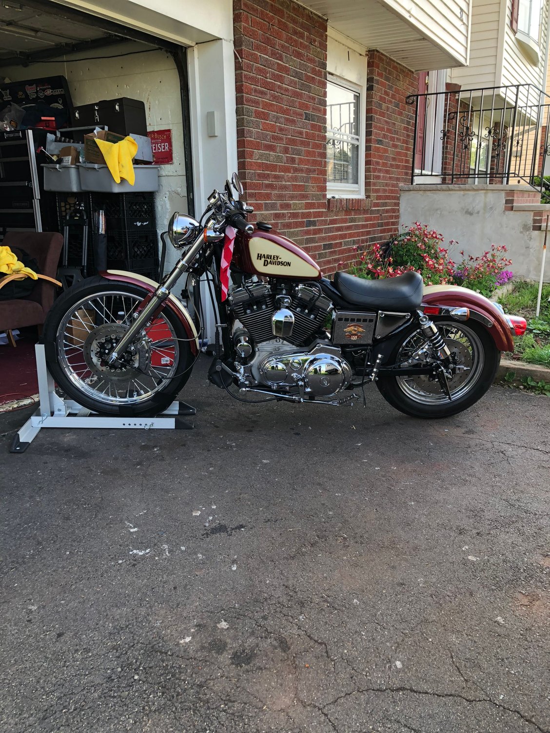

Replaced the oil pump today and that was a pain the *** but I got it in. Going to get it primed and ensure it’s getting pressure and get it started.
Still thinking it has a bad leak from the case so likely pulling the motor soon.
Old Jun 14, 2018 | 07:27 PM
  #35
Ben221's Avatar
Ben221
Joined: Dec 2012
Posts: 1,686
Likes: 242
From: Glen Mills, PA
The case leak is now what I will call a weep. Lol. Maybe a teaspoon a week and does not get worse when it runs. Maybe the heat closes it up a little.
Took it for a little ride around the block and the brakes are good, shifts through the gears fine, clutch is okay so time to put the plate on it and run it a few miles to make sure it’s safe.
