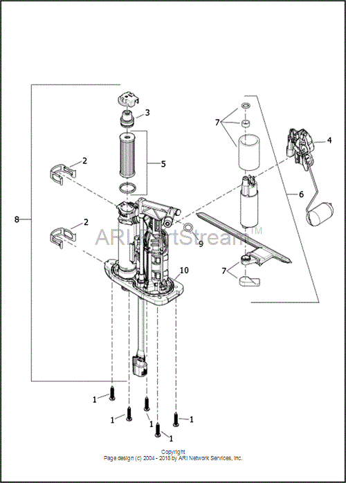

The assembly from the new softails has a float to read the fuel level. Could that be frankensteined onto the sporty fuel assembly? The part (61200057) is $50 so I might dig into this
At the beginning of the year I added the analog tach / digital speedo along with the fuel sending unit to my custom. There's not a lot of wiggle room in the 4.5 gal tank to get the fuel pump assembly in. If you can fit that Frankenstein float into a sporty tank than H-D should hire you for their engineering department!
Ha, yeah I'm sure it can be done a'la ship in a bottle, but if I ever need to get the pump assembly out again..
What kind of fuel sending unit do you have? I've been thinking about the fuel gauge kit specifically for sportsters, and just using the fuel level sensor thing from that kit.

I order the Sportser fuel sensor kit from Surdyke part number 61200008A.
Thanks, I'll be picking one of those up for sure!
