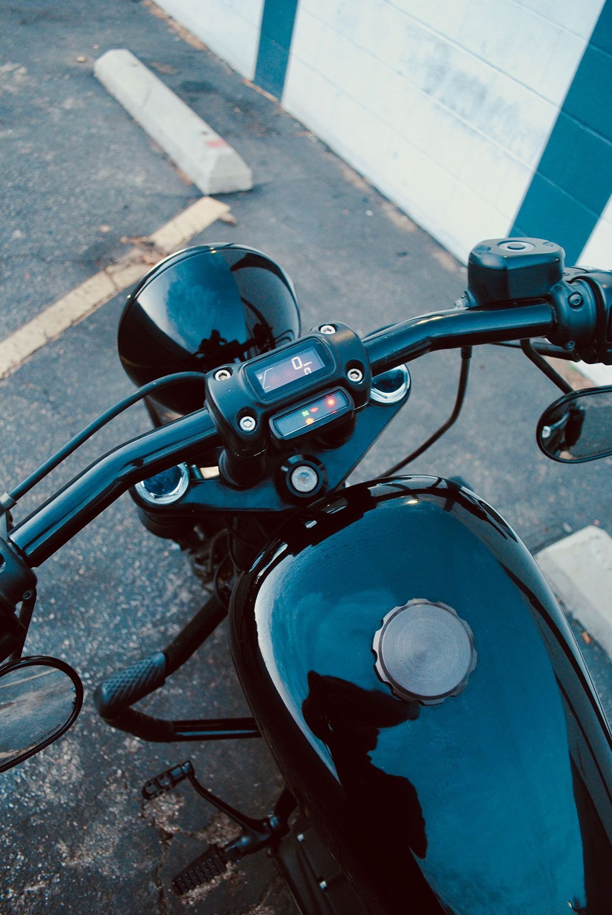

Old Aug 16, 2020 | 11:54 AM
  #50
Airgroom's Avatar
Airgroom
Joined: Sep 2017
Posts: 109
Likes: 23
From: High Desert, CA
Finally got around to upload some pictures. The speedo works great.
If you want the fuel gauge to work you'll need to get a fuel pump/sensor from a m8 as well, I haven't bothered with that and just use the trip meter to give me a ballpark
