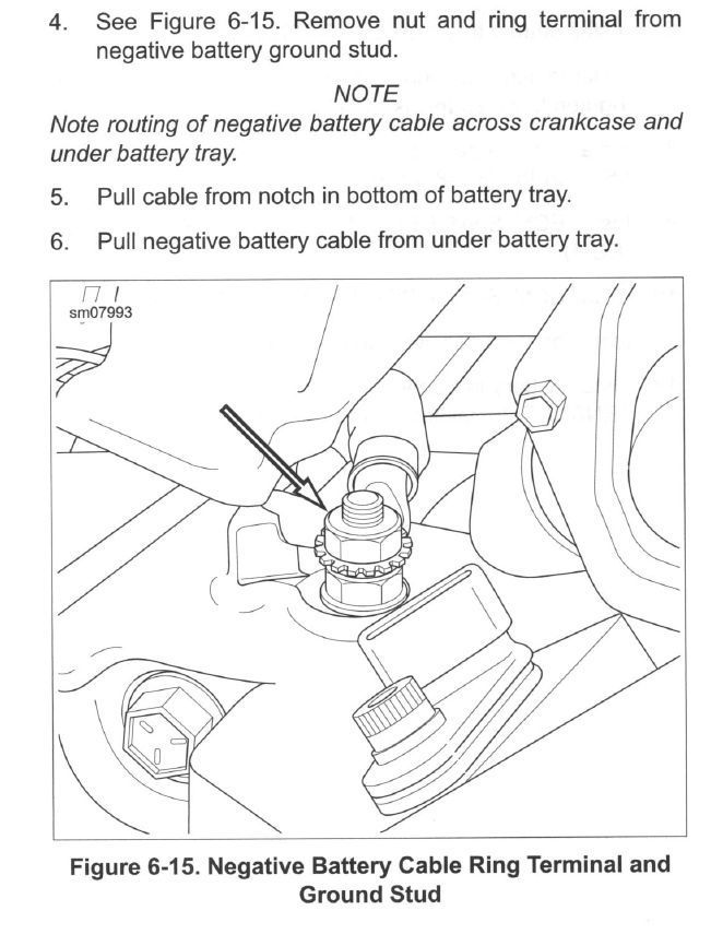

I am working on a 2017 sportster custom 1200 and the negative cable going from the bike to the battery has been removed and I am planning on replacing it but I wasn't the one who removed it and I am having a hard time finding where it connects to the bike. Any help would be appreciated. Thanks

Just behind the starter
