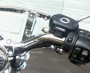

My $0.02: You can cruise a little below 2,000 RPM on flat ground but don't add throttle below 2K. If in doubt, downshift. Cheap, small tachometer mounted on master brake cylinder works for me.
