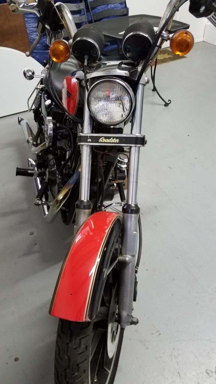

I am going to look at this 1982 XLSA in the Orange and Black trim. The paint is all original, but it has not been run in about a year and the last time they told me it had rust and liner clogging it up, hence why it was parked. I have this picture of the inside, I know it sucks, but you get what you can from the current owner. I have researched how to clean it and reseal and all of that.
My question is should I reseal it? I know Harley did not start liners until the mid 90s (correct me if I am wrong) and I am not sure if this is liner or the natural color of the tank (again, crappy photo). Or, should I leave it natural without sealer after I clean it as we ride year round here in Florida and even though this will not be my daily I plan to ride it quite often.
Here is a picture of the bike. This is a project bike and not something that is perfect, but it is kind of nice.
Thanks and look forward to the replies.
Rene
