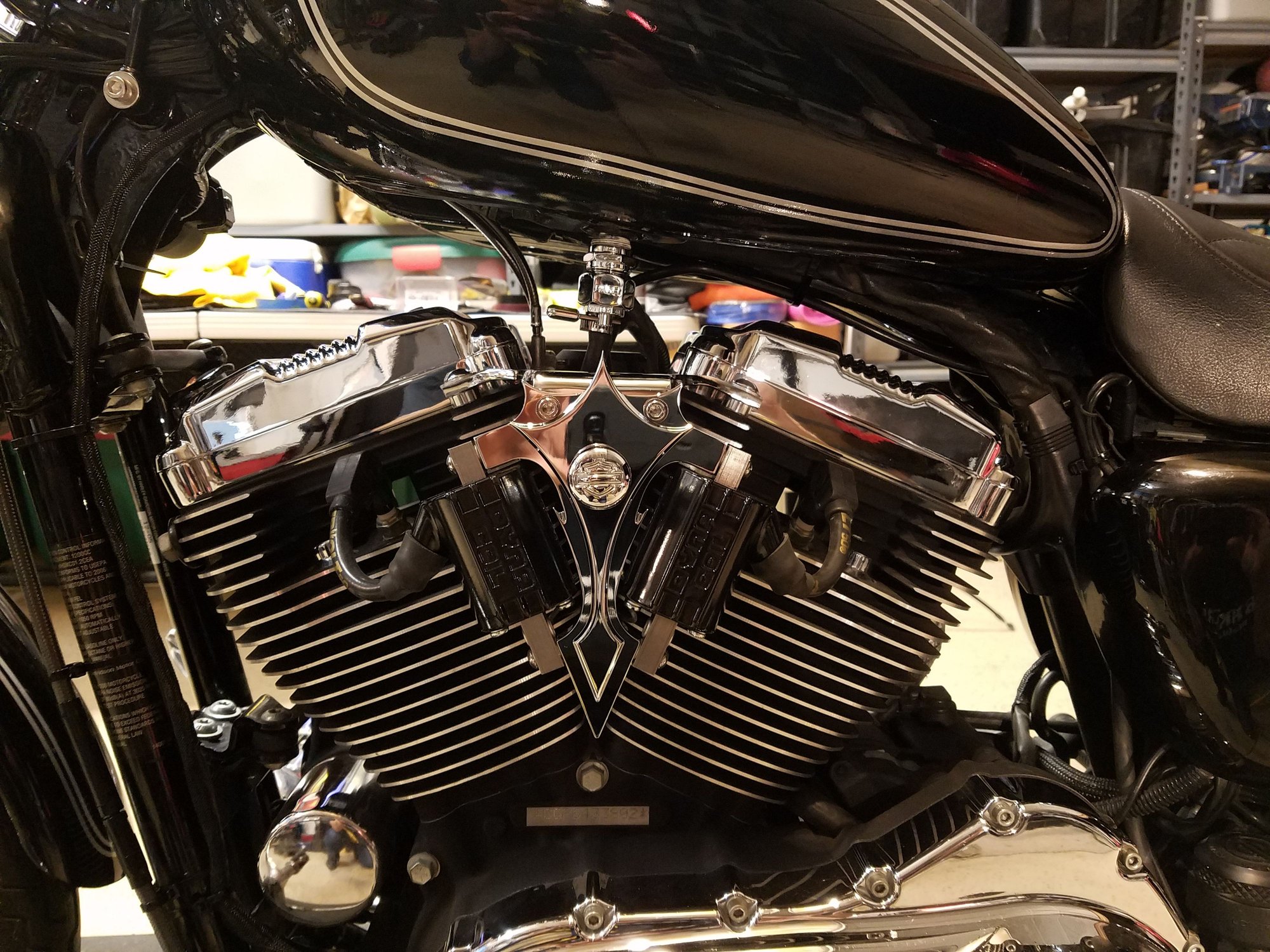

call DK or drop em an email. they have super friendly and helpful customer service. Here's what I did with my mount, used a big twin bracket and made some modifications to the mount. ran my choke through the center of the spot that most people put the ignition. I wanted the coil set up to have some appeal
