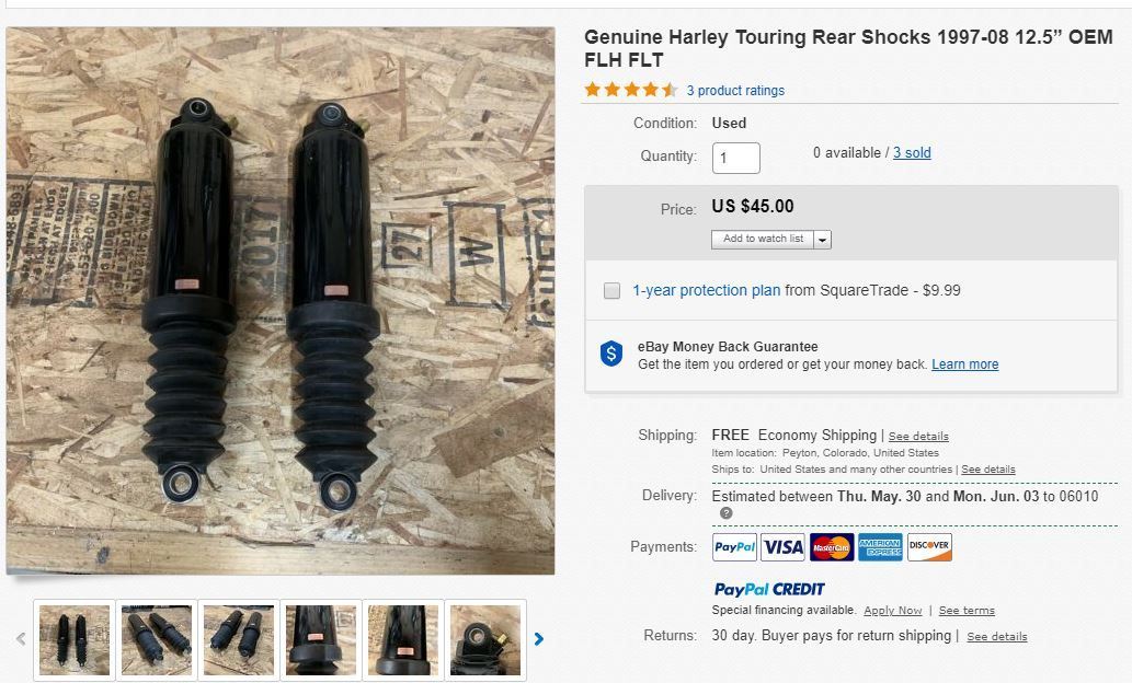

I was going off the list posted in this thread. Hopefully it helps https://www.hdforums.com/forum/sport...sportster.html

    54532-85
    54536-02A
    54540-93
    54565-09 FLH FLHT FLHR FLHTI 13" (G5E3-00)
    54565-97 (A) FLH 13"
    54565-97 (B)
    54565-97 (C)
    54631-02B Road king FLHRS or FLHX or FLTRX 12" shock pair "low profile"
    54632-98 bagger 12" or 12.5
    54635-09 12"
    54661-02A Road King FLHR Street Glide 12" single shock "lowered"
    54662-09 Street Glide and Road Glide Custom 11.5"
