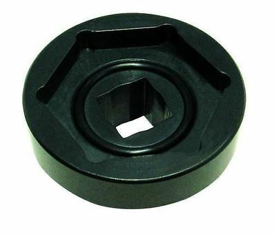

… To make life easier when changing fork oil later, you may want to replace the cap with one of these.
And combine that with a ratchet socket like this one to make your life easier:

Yea those caps would make changing the oil easier. That ratchet socket, is square but the hole on the cap is hex. How does that work?
Also, my springs were progressive. Tighter coils at the bottom, and more open coils at the top. Is this stock?

My bad, here is what I have, and it works with the above ratchet on the STOCK fork cap:

Ok that make more sense
