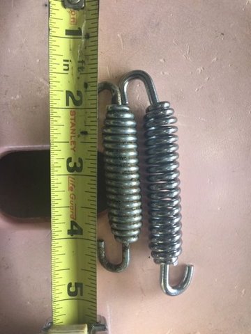

I have a 2014 883 Iron Sportster. That the Jiffy stand is loose on. I replaced the Spring as well as the bushings and pin. It is still loose nothing looks bent or damaged. I would not worry to much but it is now to the point it drags the ground when turning left. It looks like a shorter spring will fix the problem, but the spring is pretty specialized with the rotating hooks on each end.

Sounds like a shorter spring is in order...those springs are common.

Get a 4" spring at Home Depot. My kickstand was super floppy, not anymore! I have an extra one if you want it. No rotating hooks, but not necessary either.
John
On my bike with the stand down the coils of the spring only measures 3.5 inches.
It's 4" OAL, not the coil length. It works great, took the advice of other members here and XL forum.
