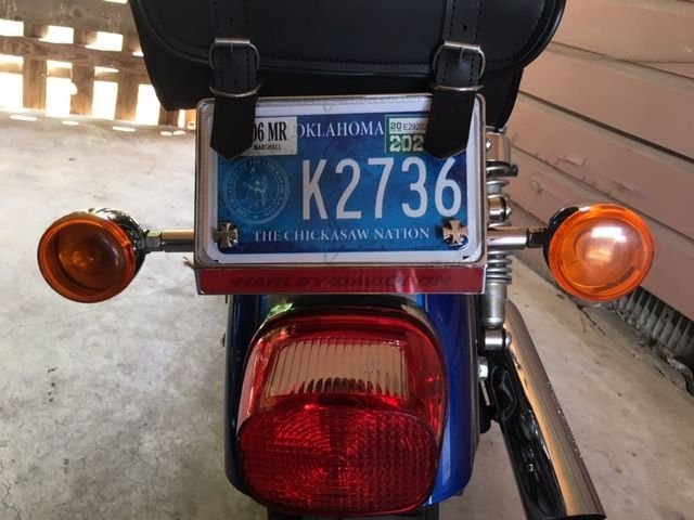

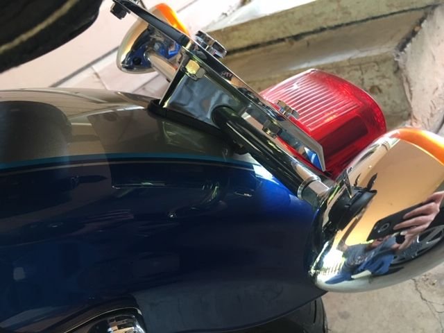

Not hard to make a DIY relocation setup, this is just tubing and clamps I picked up at the local hardware store plus some aftermarket turn signals I had on hand. The fender already had a hole IIRC and I just drilled one in the license bracket and tube to line up with it.
Not sure where mine came from but it's the same type of mount only factory.

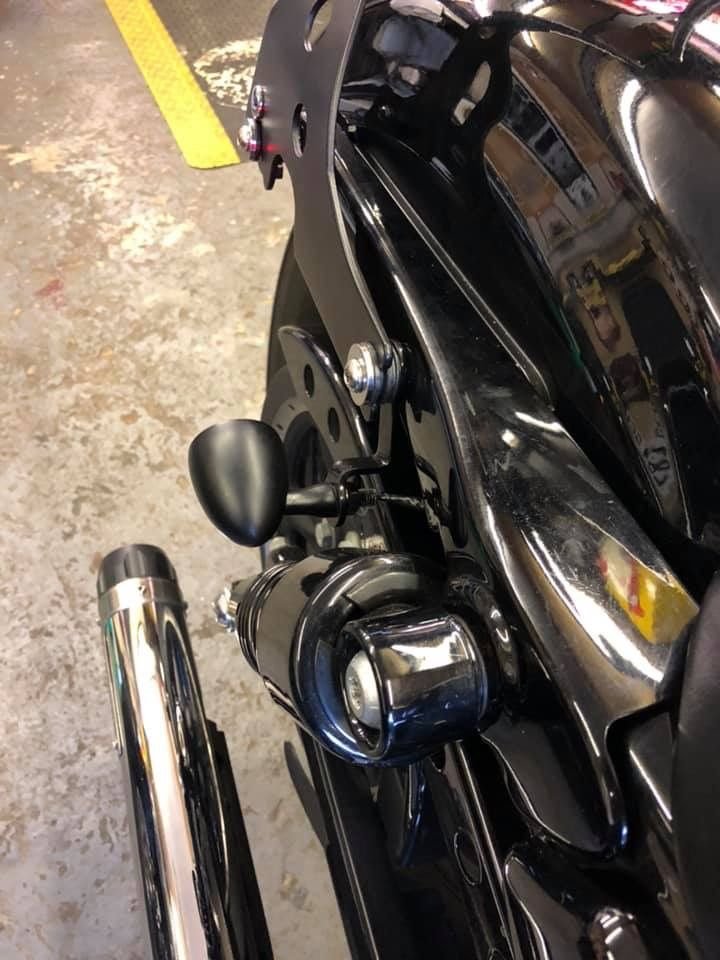

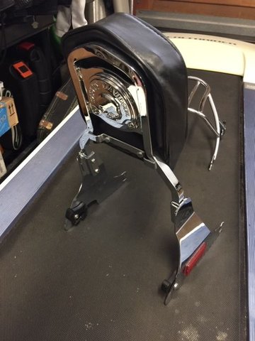

The docking mechanism for the detachable sticks out unfortunately, which I imagine would be about the same size as my turn signals.
I might need some type of bracket like these to keep the turn signals.

As you can see from the picture. My turn signals almost sit flush with the swingarm. The docking mechanism, I imagine sits out further which would block the signals.
