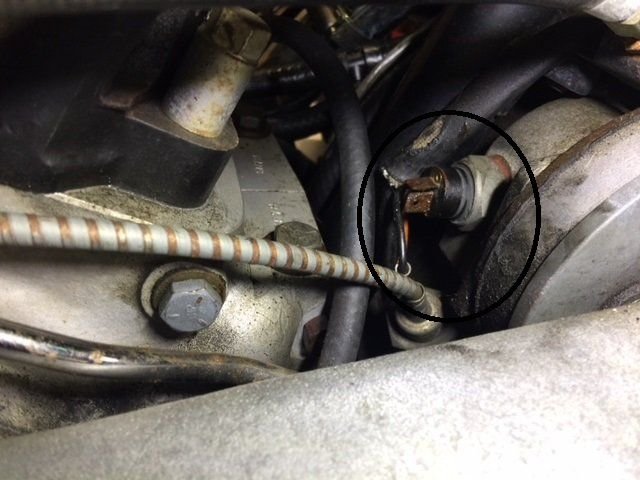

True, it could be the wire connectors not making good contact with the switch posts...also check the other end of the negative wire.. This is a pic of the neutral switch on my shovelehad....not sure where it is on new bikes since never had issues with it on my sporty.
If it is not the connectors, replace the switch...may not be making to ground in the trans when in neutral.

Unfortunately on the new bikes it is just behind the front belt pulley hence my earlier comment.
