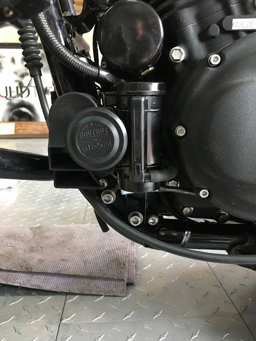

I know the '48' has forwards, so this location may not be an option. Here's where
I located my Stebel....
good luck,
T.
good luck,
T.
Do you have a link to the horn? I run mids and would love to explore this option. my horn on the 07 883r sucks as well.
