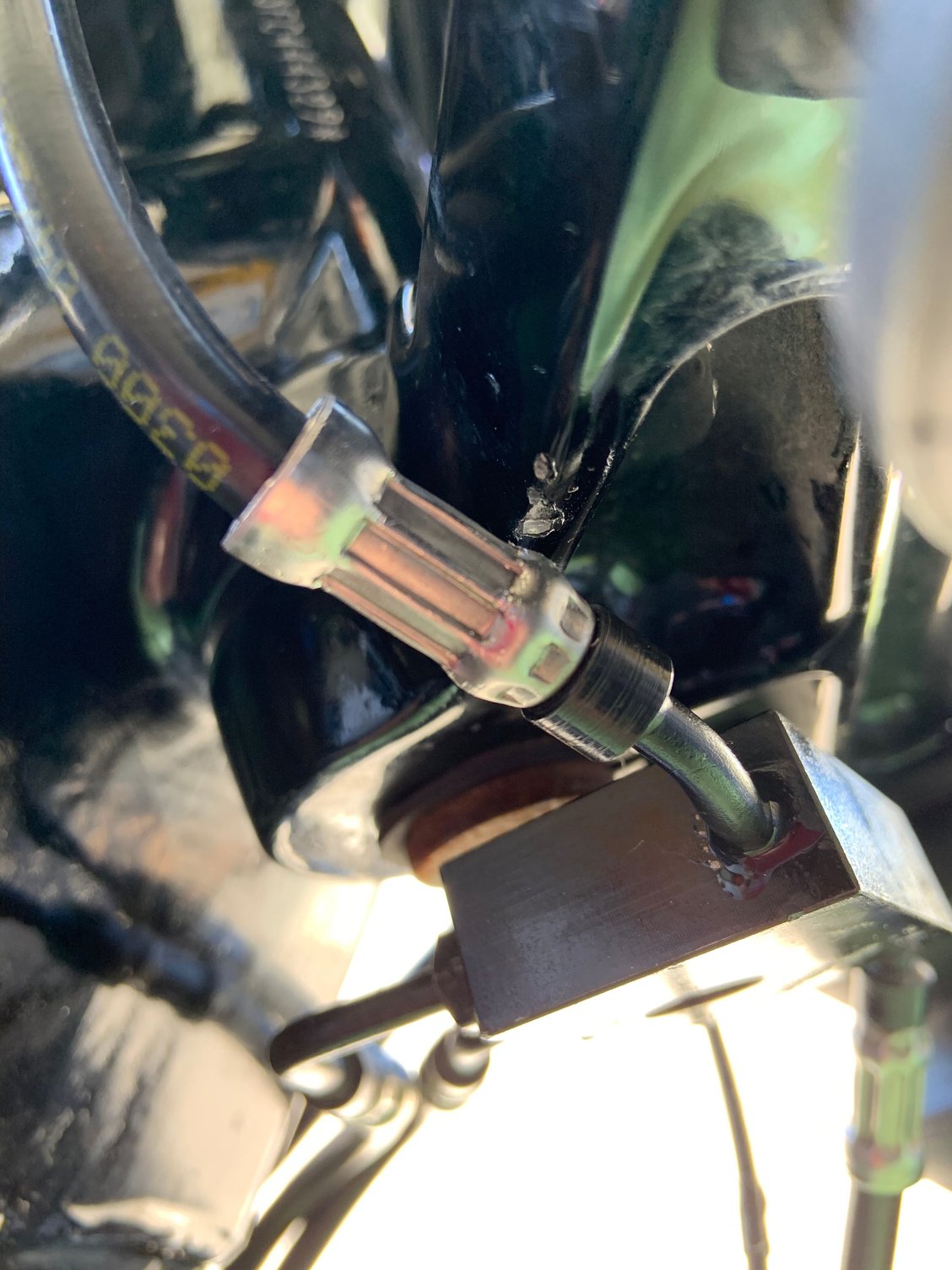

How do I remove this silver threaded piece so I can replace the black box that is clearly leaking, thanks!

Unless I'm mistaken , that is very firmly crimped on and does not look removable . If it unscrews from the black bit then I suppose you would grip it very gently with a Vice Grip and turn it .

It is part of the brake line assembly, not removable.

You don't. You have to replace as the entire assembly. That hose is crimped on.

As the other chaps have commented. If there is any leak in that brake line, simply replace the entire thing. It is cheaper to buy a braided line, which will also improve braking feel, so you gain more than just a replacement!

I did the braided lines and it was a very straightforward install. I got mine from Hel; the distributor is in PA and he was very helpful. The brakes felt firmer, and of course these lines look way better than the rubber stockers.

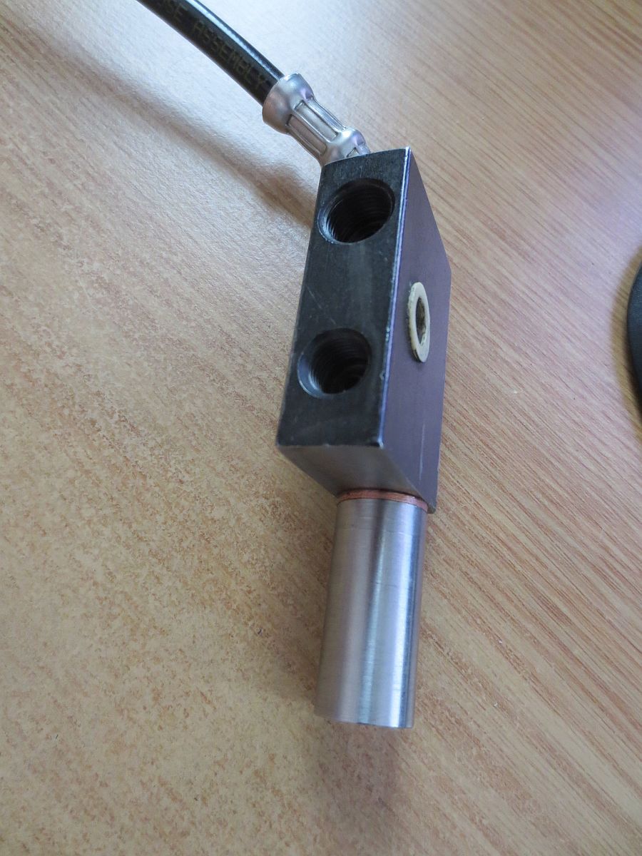

That is a one piece but you can alter them as I did a few times while installing apes. I think you have ABS on the bike so the
braded line in one piece is not an option. Just cut of the small pipe, dril a larger hole in it and tap some thread in it to put in
a banjo bolt and you can mount whatever brakeline you want.
This is an example from what I did with one....
This one got an extended bushing for the banjo bolt.
