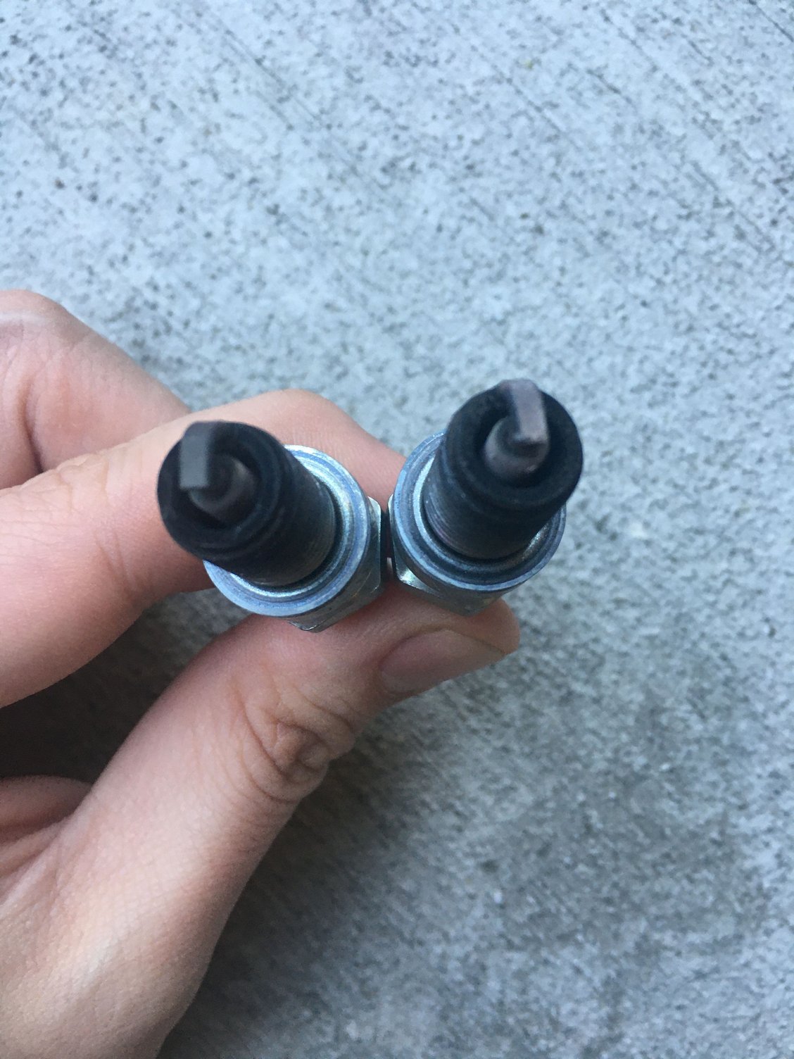

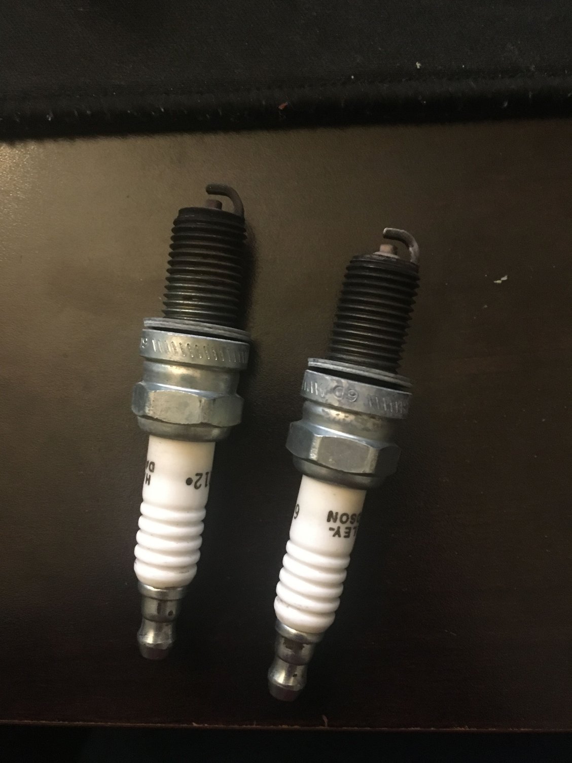

I bought a used 2016 Roadster (first Harley) a few weeks ago and its been great. Among other things its got the Vance & Hines exhaust, Roland Sands air cleaner, as well as a power commander 5 but it still has pretty significant popping during deceleration. The popping sound itself doesn't bother me whatsoever so I wasn't worried about it at first, but I can't help but think that it may be harmful in the long run. I would assume if the previous owner installed the power commander, its been tuned to some degree or at some point, but is there a way I can verify its been done optimally? I've read on other posts that SOME popping is inevitable with such a setup but I feel its quite frequent. If it had to describe it I would say 3 pops every 2-3 seconds approximately during deceleration. As far as MPG I'm getting right around 40 combined. Unfortunately I cannot get into contact with the previous owner currently.
What do you guys think?
Thanks in advance.
Pictures of spark plugs I recently swapped out.

That said, your plugs look different. I would first look for an exhaust leak.

The plugs look pretty good I think but I like to see more of an end view and a look see at the ring and the insulation color.
One plug looks a little richer than the other (by what I can see of the ring) but thats probably normal IMO.

The last two fill ups were almost 2 gallons on the dot and the trip odometer read 77.x and 80.x. By my estimate, both fill up consisted of around 20 miles interstate (~70mph), 40 miles cruising (non stop around 55-60 mph), and 20 miles stop and go city. I'll try to get an more accurate/consistent MPG when I can. I haven't had a chance to do anything with the bike since the last post but these are some more pictures of the old spark plugs. I'll update the thread once I get some more information though.
