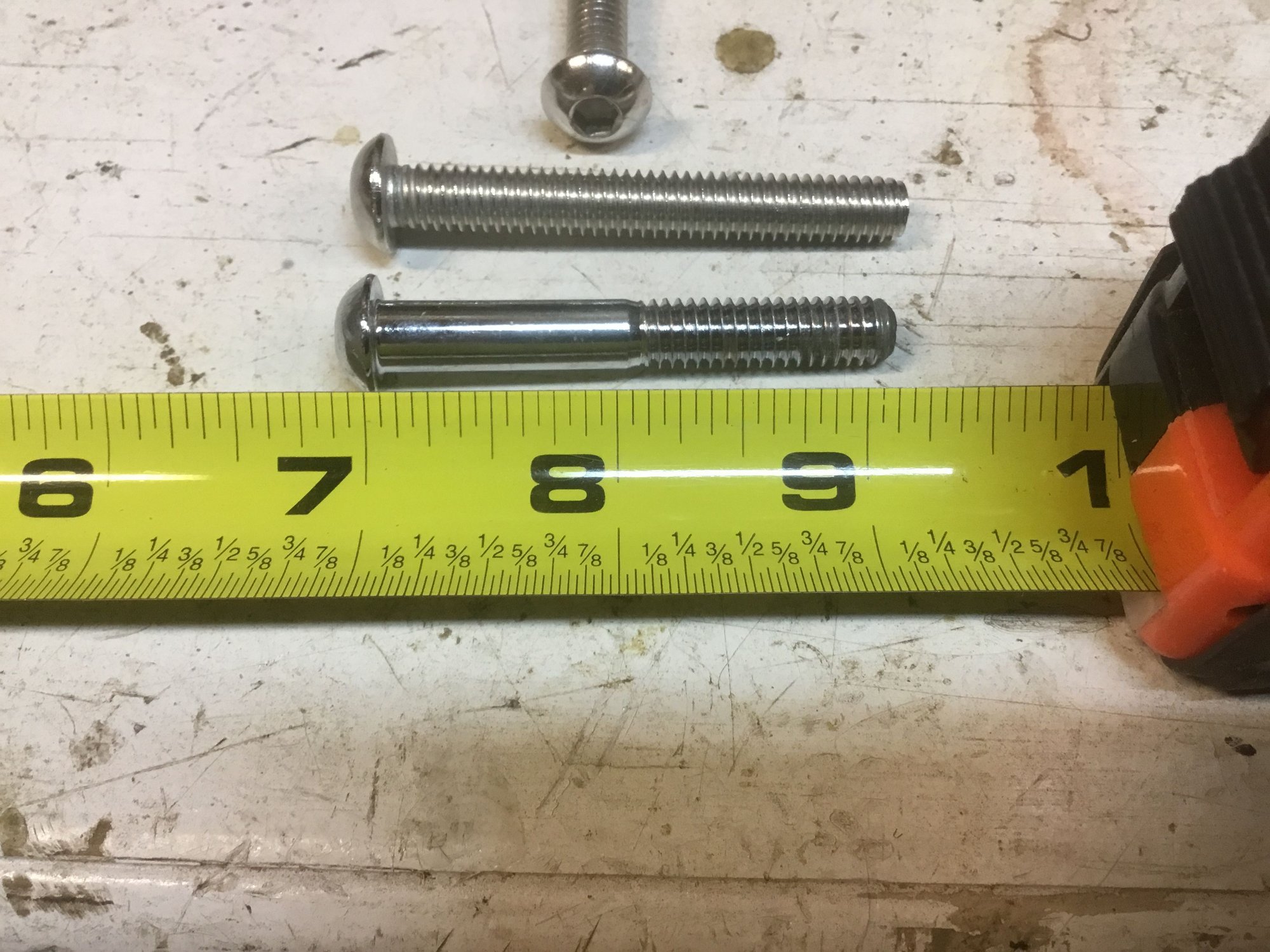

My detachable sissybar/backrest/rack did not need the rear turns relocated. If there is a notch about 3" long in the bottom of the side plates you prob won't have to either. I ended up moving mine later for saddlebags anyway.
Pics of your setup will help. Mine was already on my bike so I am no help on bolt length.
Actually, I might still have the ones that were in it. I swapped mine to add the attachment points for my saddlebags. Will post in a minute.

Ok I found the ones I THINK were what HD used to add the quick detach points for the sissybar.
The camera was hard to line up correctly, but I THINK the chrome one on the bottom was the HD part, and it is 2 3/16" long, and pretty sure 5/16 coarse thread. The ones above were what I picked up at ACE hardware. About 3/16" longer and stainless steel. All are allen head cap screws. Don't take this as gospel unless someone can verify. Again, these were what came from HD to mount the sissybar QD attactment points.

i added the saddle bag brackets so the button head bolts needed to be 3 inches long
