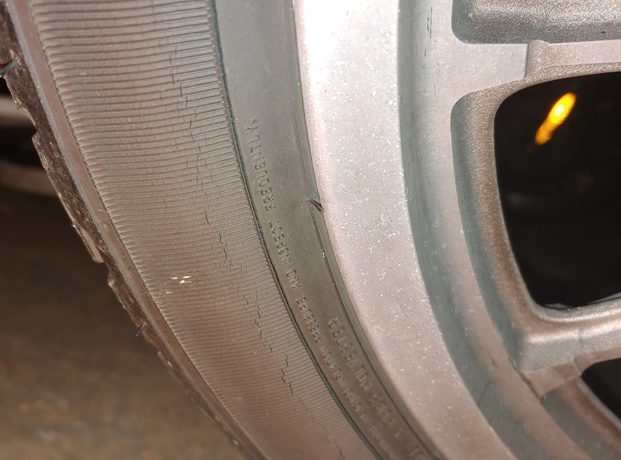

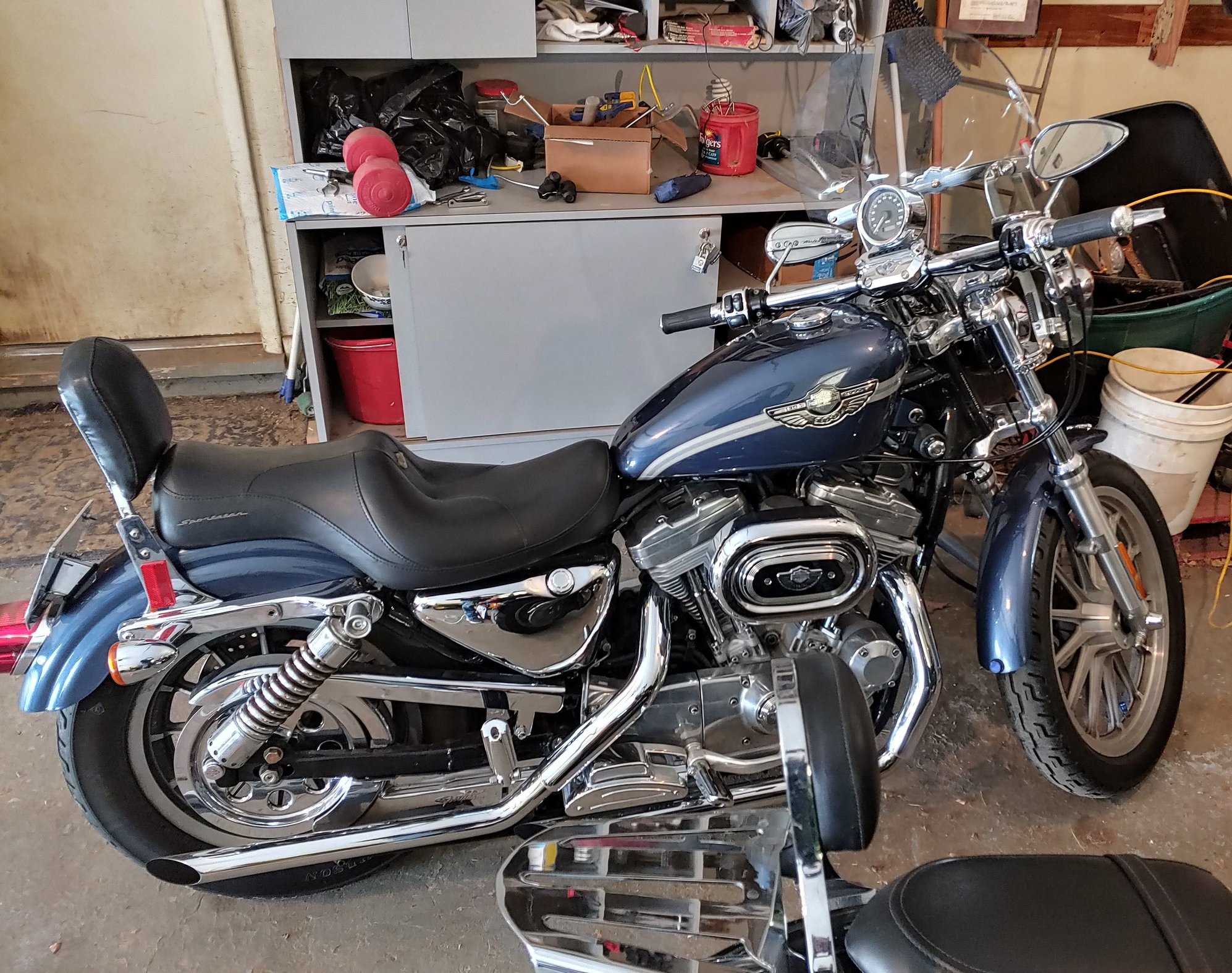

Haha yeah, I could share it with you guys since you've been so nice to help me. I'll get some better pictures at some point, but for now this is what I got on my phone. Ignore my messy work area :P. It actually had a "trike conversion kit" on it when I got it. The lady dropped it once, fortunately only damaging the brake lever (which will be fixed posthaste) and the plastic bit under the throttle handgrip before putting them on. I took the darn things off and it's pretty nice. They seemed rather unsafe to me haha. Mid controls with drag bars and straight pipes is pretty sporty feeling, but I kinda think I'm gonna change the handlebars at least. It's a fun ride but I can't do it too long leaning over like that. The main reason I haven't put a bunch of miles on it to test how it is at the moment is because the front tire is dry rotting a bit and I'm not sure how safe that is. It's held air fine so far but still worries me haha. Just another victim of sitting for 2 years lol. I might take a video riding it around town if my cellphone video stabilizes well enough.

@solesoul ,thats a lovely looking sportster.
,and that front tyre. needs changing
bet its the original tyre my. my front tire went like that ,i had to to put new tyre
fot bike M O T bike inspection every three years ,here in UK

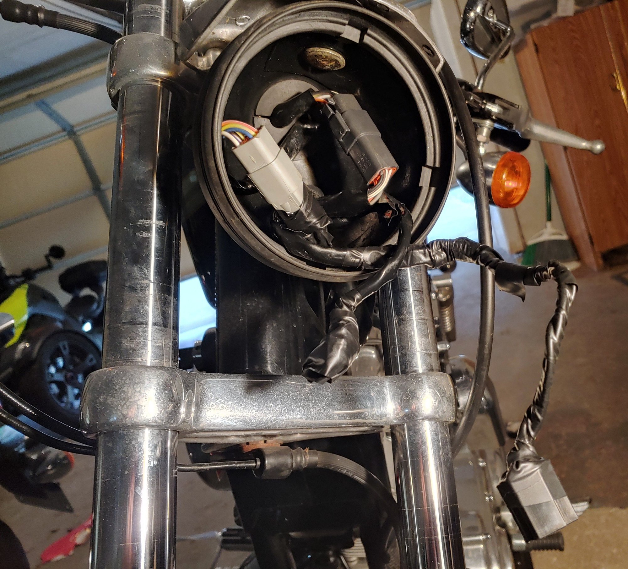

Thank you! It's actually in really good shape for a 2003, so I'm happy to have to do a little TLC here and there to get er reliable. The tire is pretty old but according to the time stamp on it it's from 2011. Definitely gonna get it switched out for some new rubber asap. Also, update on the headlight. I took it off and looked inside and the rubber bit behind the light melted at one point, and someone has done some real Frankenstein wiring in here. The original plug is melted shut and was covered by electrical tape and hanging there, and something I can only refer to as hackjob-splicing went to a new plug with all black wires into the headlight that gives me that dim-at-best glow. Lol I'm not even sure what to make of this, but it's pretty funny. I'm thinking I'm going to end up having to buy a whole new... something. I'm not sure what that something is, but it'll probably have to have a lot of wires.

Took it out for a bit of a spin and it ran like new. I even adjusted the clutch a bit and made it feel so much nicer to ride. The headlights are all sorts of messed up but they work in a pinch and I don't smell any smoke, so I think I'm just gonna leave it as it is lol. Thanks for the help, everyone. You guys are awesome.
