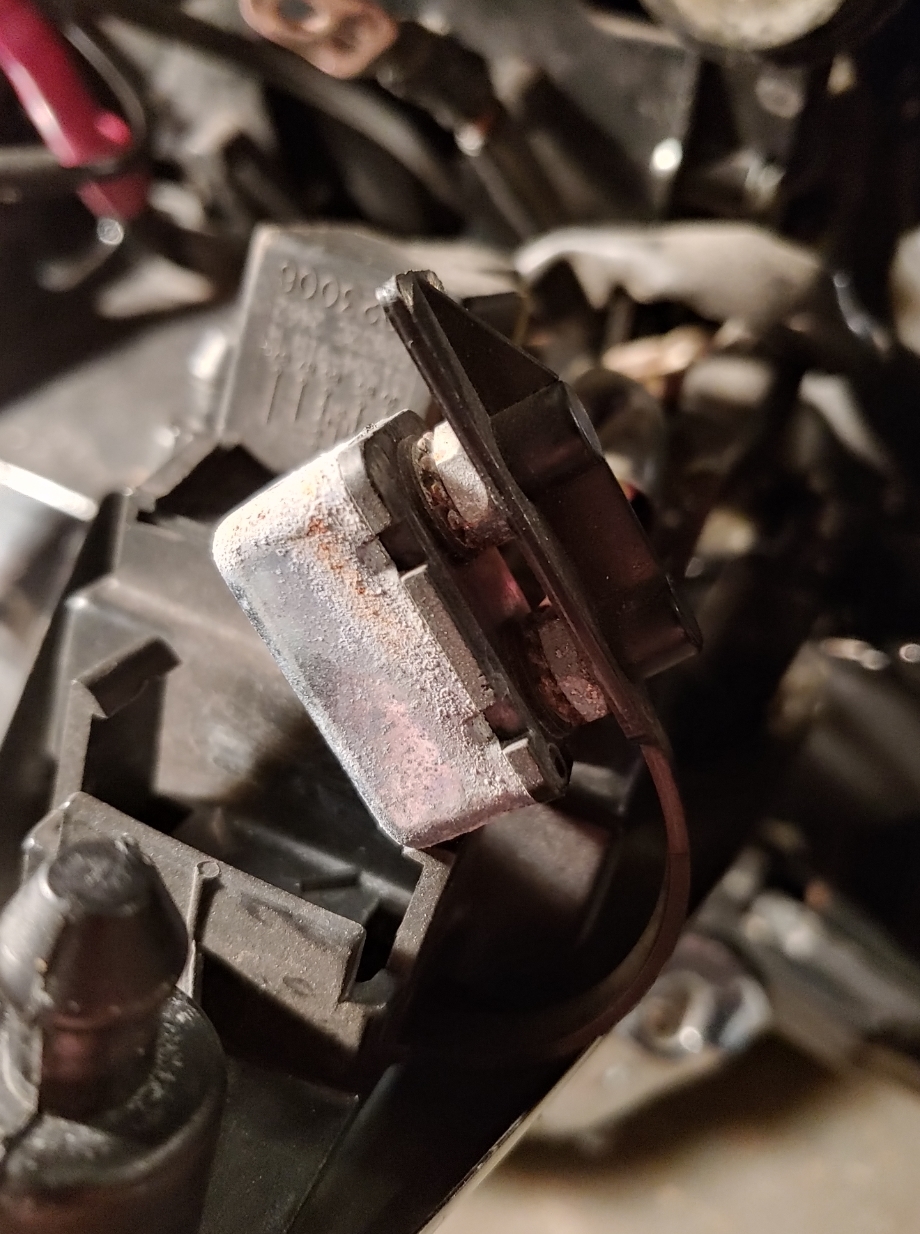

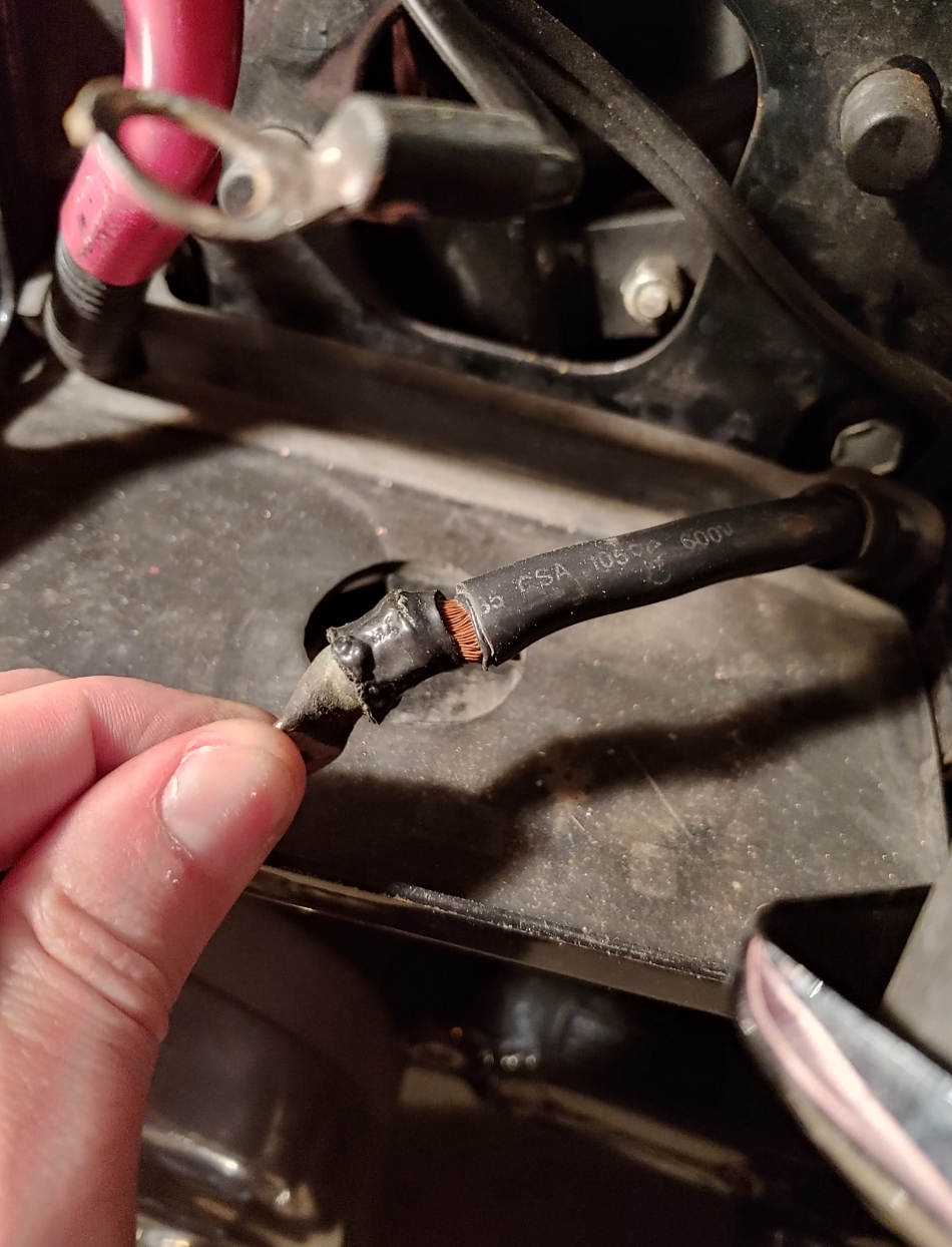

Thanks for the welcome! Yea, I wasn't sure what to look for but I went out rooting around and checked for anything that seemed odd or bad to me and I noticed that the negative wire had melted some, and part of the battery had melted too where it was connected. I also found this nasty looking thing little box, but I have no idea what it even is haha
For some reason, the pictures aren't uploading so I'll just link them to you https://i.gyazo.com/5455d0a0ac5674f5...8cac105da5.jpg https://i.gyazo.com/d5411d9427d2015b...85d3a5d848.jpg https://i.gyazo.com/6335fd17103f49b6...473a198903.jpg
The connectors were also pretty gnarly looking, in particular the negative, so it may not have been making the best connection. Hit both with a bit of sandpaper to make em sparkle again but I really don't think that's the issue. Since I don't have the tools, I'm probably gonna head down to the auto store tomorrow and have em test the battery and see what they say. It's from 3/18 so it's not super old, but it also didn't get used more than 3 or 4 times since it had been installed before I bought it. I'm no expert, but the regulator would a regulator cause that? It was the negative so I was under the impression there wasn't even any voltage over it but I'm also clueless. Also, my headlight basically doesn't exist. It was hard to notice in the day time, but then it got darker lol

Get a new negative cable, even though the outside looks good, the inside could be corroded. Loose connection will make resistance and heat to melt stuff. Looks like you have some maintenance to accomplish. Good Luck!

Thanks guys. For now I dug around and cleaned up the contact points with some sandpaper til it was nice and shiny and covered the exposed wire. Actually, when I started it up it started so strong it actually startled me. Previously it was kind of like a bear coming out of hibernation. I haven't noticed the issue since then, but I haven't gotten a chance to put much time on it yet. I figure it's probably good now, though. The only issues I can see at this point is the headlight is really dim and the hi-beam indicator doesn't come on, but I don't care too much about that right now as long as it's running good. I'm probably gonna order me a new ground to put on the battery just to be safe. I'll pop back in if I run into more issues. For now, I really appreciate the help guys. Y'all are awesome.

Glad to hear you made progress, and thanks for posting what happened. I didn't have much to add other than that box thing looks odd. What's it connected to?

Thanks for the link, I'll probably grab it. Yeah, the battery is fine. I started it after it sat for a day or two without charging it at all when it started slowly previously, so obviously there was a big difference haha. That box thingy is stuck right on the back of that little triangle side cover that just pops off. Found it while looking for the fuse box. I tried to check the diagram reading that thing was hopeless for me haha

The box thing is a relay, just a little oxidation on the outside. Once you get the new ground cable, clean everything up again a use a small amount of dielectric grease on all the contact points and exposed metal contact points. Not gobs just a little wiped on while wearing some rubber gloves, it will help at keeping the corrosion down. Good that it is working for you.
