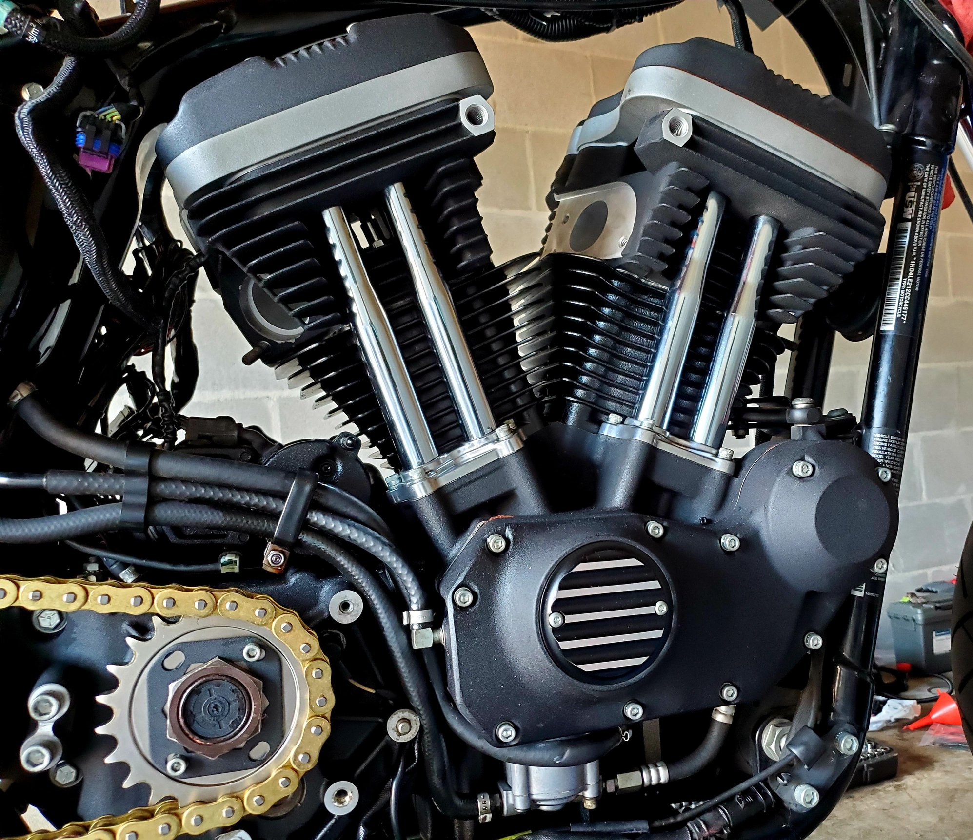

Here's mine

Looks awesome mate. Thanks for the advice I did see her video and was going to follow it, but it seemed like it was just to easy so thought I'd check on here.
