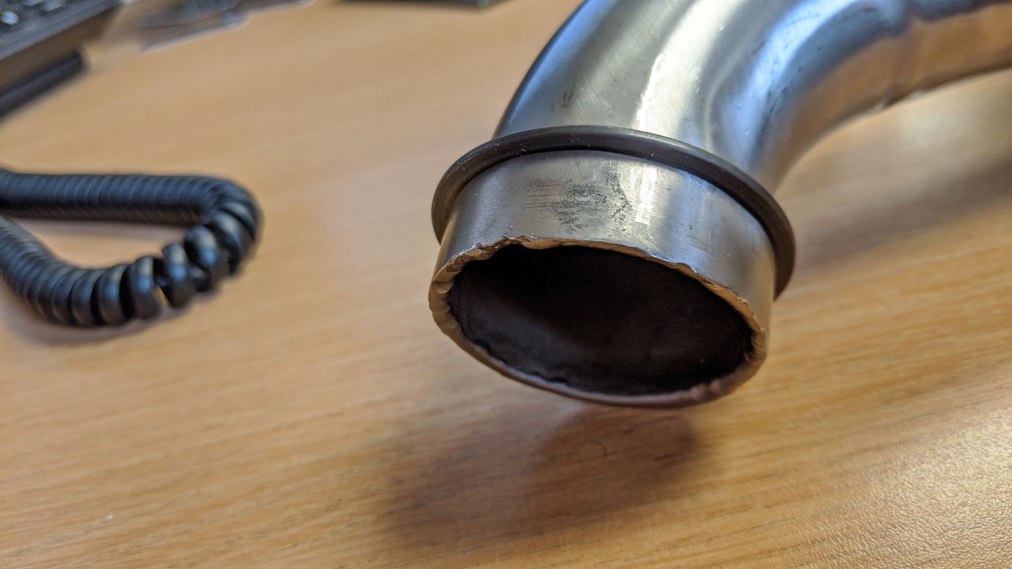

I have a brand new set in my garage that I was going to try out since they are relatively cheap. Wow, what a mistake that was. I am in the process of returning them now.
The quality is ultra-poor. I couldn't bolt them on due to these reasons:
  1. The O2 bungs were a different thread pitch between the two pipes
  2. The flanges where the pipe mounts to the cylinder heads were not flat; crappy welds that were not cleaned up
  3. I own paper clips that are thicker than the metal stock these pipes are made of
  4. Muffler was scratched up badly
I emailed J&P and told them they should reconsider selling any cheap Chinese crap that DanMoto is selling there. It was really, really bad.

From: Omaha,NE

Originally Posted by strych9
Wow, no wonder they want you to use a different port gasket. What would using a bench grinder to cleanup the edge do, it looks like theres plenty of edge ? It looks like the SS thickness is decent.
