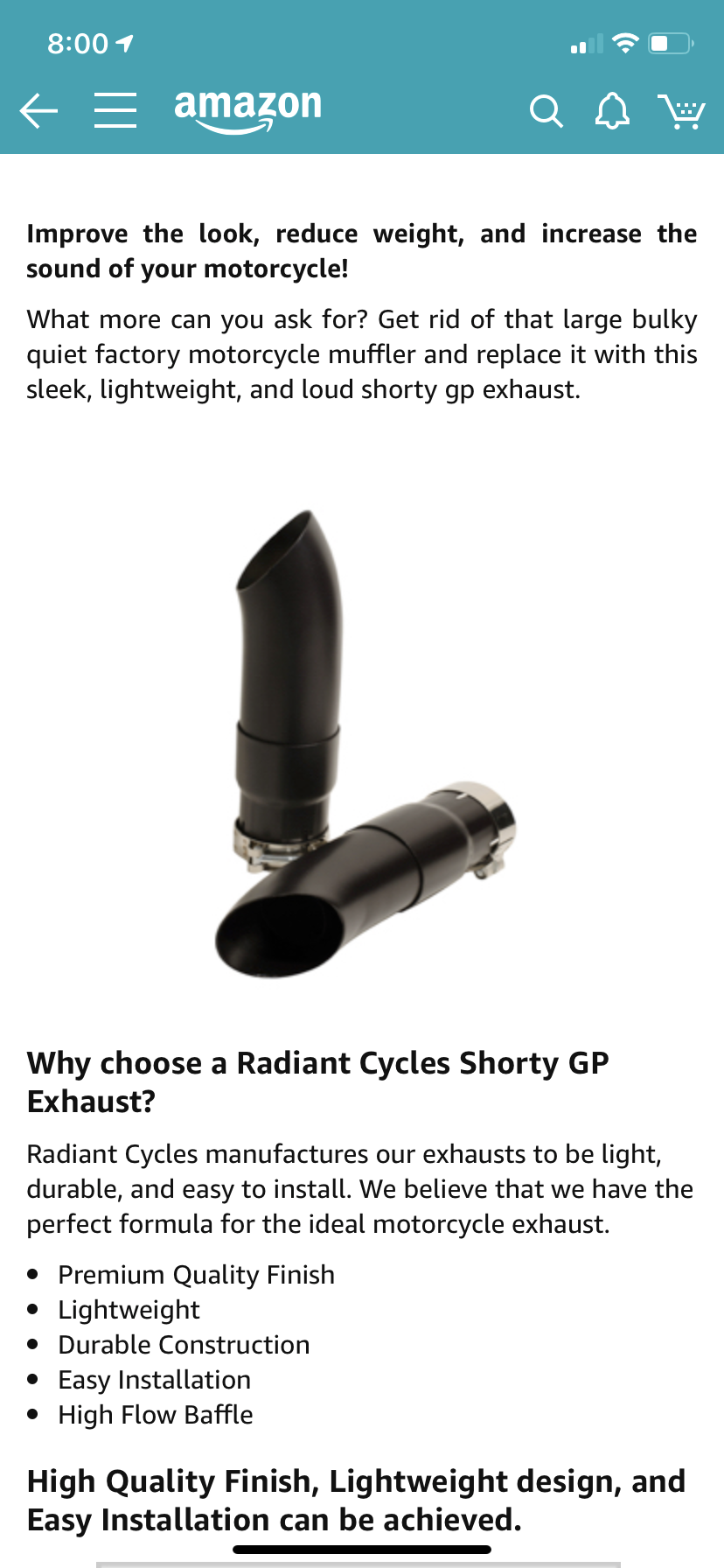

Hey y’all, I bought some slip-ons for my 2017 iron 883. I did this because I don’t have the cash to blow on a full exhaust, ac and tuner (stage 1). But I need louder sound (loud pipes save lives), because stock mufflers are too quiet!! They are 9” shorties though. My question is, will I hurt my motor or anything on my sporty by running these and not getting a tuner?
link to the slip-ons I got:
Radiant Cycles Shorty GP Exhaust for 2004-2018 Harley Davidson Sportster 1200 Black https://www.amazon.com/dp/B07H5S8W1G/ref=cm_sw_r_cp_api_i_h63PEbQMT9CPR
Photo of 9” slip-ons I ordered.
